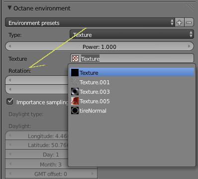

Hi JimStar, I am missing the Rotation settings in texture environment panel.
If I add a Rotation node it work not correctly.
Picture is from manual.
Cheers, mib
Cheers, mib

Hi JimStar,
the rotation can or even has to be managed over a transformation node in the node editor: Or are you just missing it in the place directly in the panel you showed?
Greets
PeterLux
Greets
PeterLux
