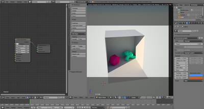

Hi Jimstar,

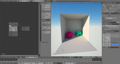

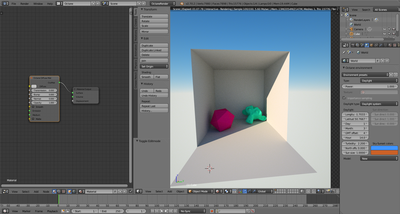

I switched to Mint 16 and it's working better now. :) I did find one small bug, when you are in render mode in the viewport and switch to camera view, there is a vertical bar on the right hand side of the viewport that just displays the alpha checkerboard pattern. The scene shifts towards the left also in camera view so it doesn't line up with the other mode views. If you switch views the bar stays until you go to another display mode.
When first going into rendered mode:
Then after switching to camera view [0 key]:
And then after going back to user view [0 key again]:
