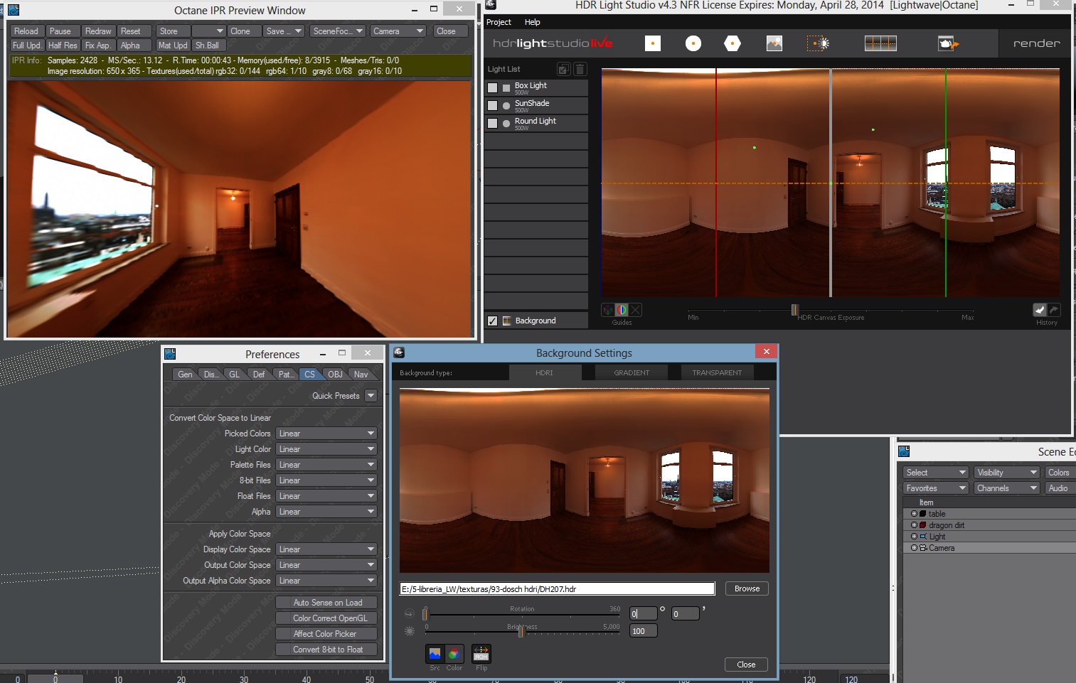

Ok ... I am testing the HDRLS issue here and I can't reproduce it. I tried several HDR images as backgrounds and they are rendered in Octane like as you can see them in the HDRLS interface. Are you sure that the LW color space settings are all set to Linear and you don't have a color corrected IPR view?
Anyway this is only a first test, perhaps I am also making something wrong. I can confirm that Octane loads the HDRLS live image without gamma correction.

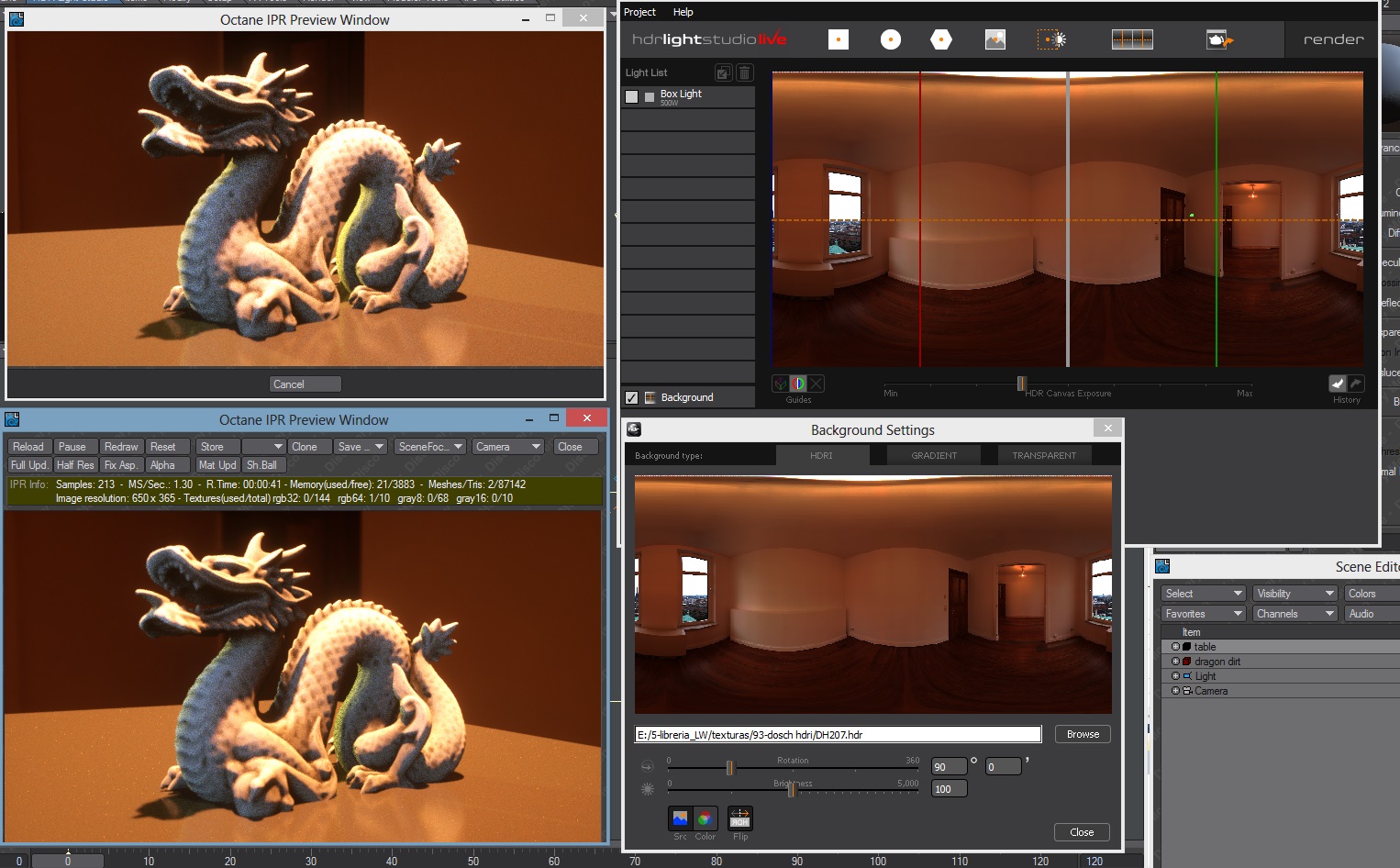

Other test ... the top IPR image was rendered using the Octane texture environment node (without HDRLS), the bottom IPR image was rendered with the HDRLS live environment ... no problems so far with this HDRI backgorund.

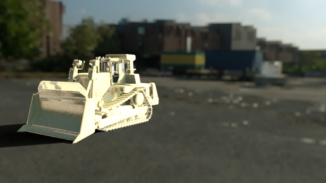

Firstly, I've always set the texture gamma to 1 for an HDRI. However, I've only ever had the Imager gamma to 1 and used the Response to have it look nice.
This shot is with my settings. Texture Gamma=1, Imager Gamma=1, REsponse=Agfa_Futura_200C, Exposure=1, ISO=100 (I like the way this looks at the click of a button)

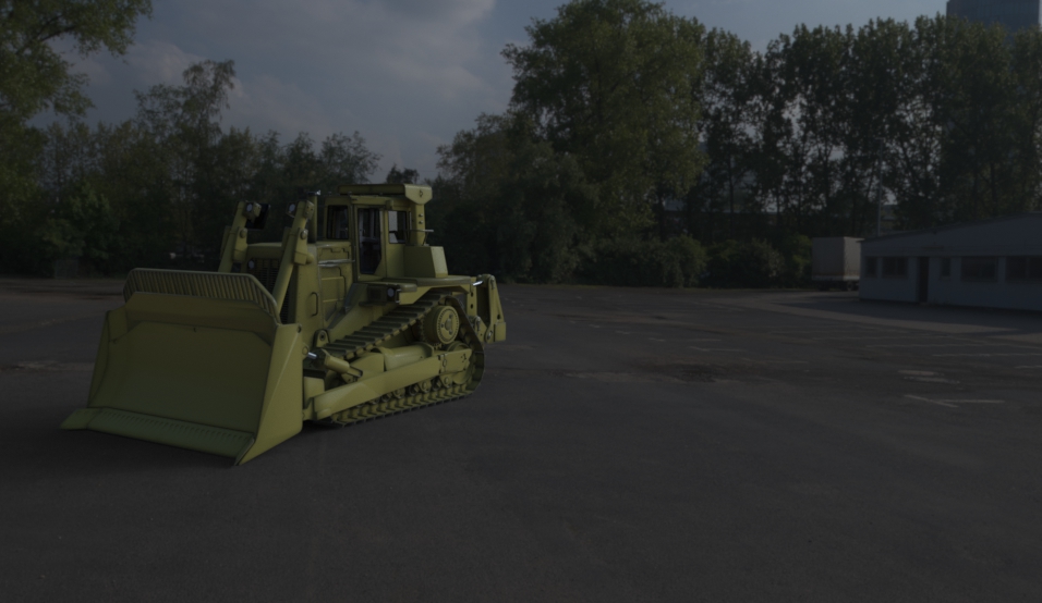

When I change the settings of the imager to your recommendations it all goes very dark... (Dont like the look of this)

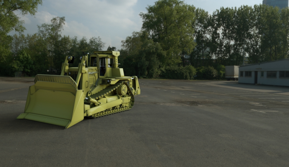

So, I tweak the exposure and ISO to get a better look

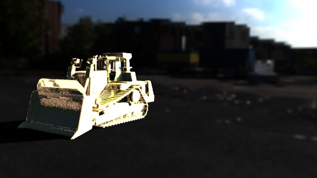

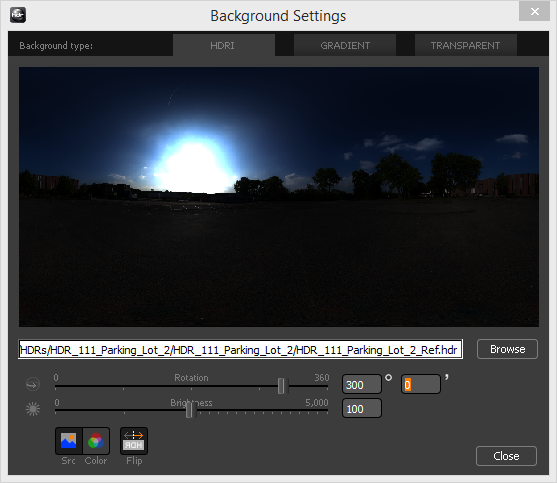

OK, so start HDRLS. Clear lighting. Click on button to get the background image. Load the same HDR and rotate to same heading. This is what it looks like in HDRLS...
And this is what IPR looks like... (Not good)
