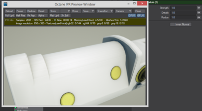

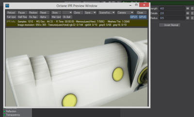

So an example of the second question. This object has smoothing, and as soon as I add the Dirt Node, it shades the polygons, revealing the underlying structure, rather than just picking out the bits I would expect a normal dirt node to do.
Also, when I up it to show more the way I want it to in the edges, it shows the polys even more so.
This can't be the expected behavour surely.
- UnCommonGrafx
- Posts: 199
- Joined: Wed Mar 13, 2013 9:14 pm
Howdy,
Went to work today.
Even diffuse reflects, but that's picking at physics...
And even if it isn't, something about the render is tied to the environment and why you get that look. Without my explanation, I am without a reason why it looks icky brown.
On the other point, yes, I would like an answer to that, as well. Dirt really messes with the normals. And there is no getting rid of that and using dirt.
Went to work today.
