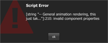

I've problem with alembic animation. Could not render my project (((

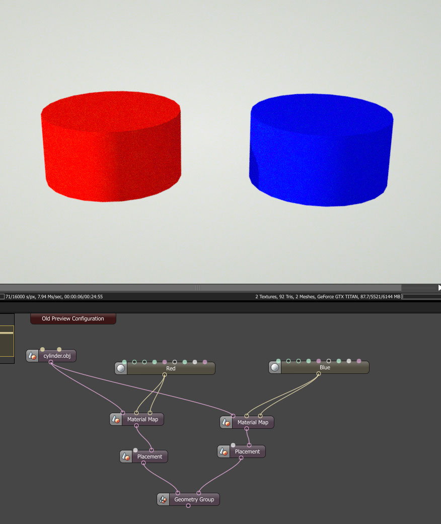

What did you get about texturing instances ? I am interested in this topic ? Is it possible to make variations to instances in a manneer that each instance is different color ? One is totally red, the other green and so on.
smicha wrote:Now I get it :oops: It works like a charm.
Thank you so much!
smicha
Posts: 3151
Location: Warsaw, Poland
BorisGoreta wrote:What did you get about texturing instances ? I am interested in this topic ? Is it possible to make variations to instances in a manneer that each instance is different color ? One is totally red, the other green and so on.
Thank you so much!
Yes Boris - you may even mirror instances and have unsymmetrical texture on them. I'll post some screenshots here soon.
smicha
Posts: 3151
Here is the screenshot - just use the material map (menu->geometry) for each instance and define colors, textures independently.

If you want to instance meshes, it is usually the easiest to copy and paste the mesh nodes. All mesh nodes loaded from the same file are always considered instances.
