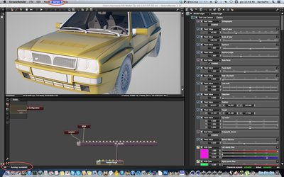

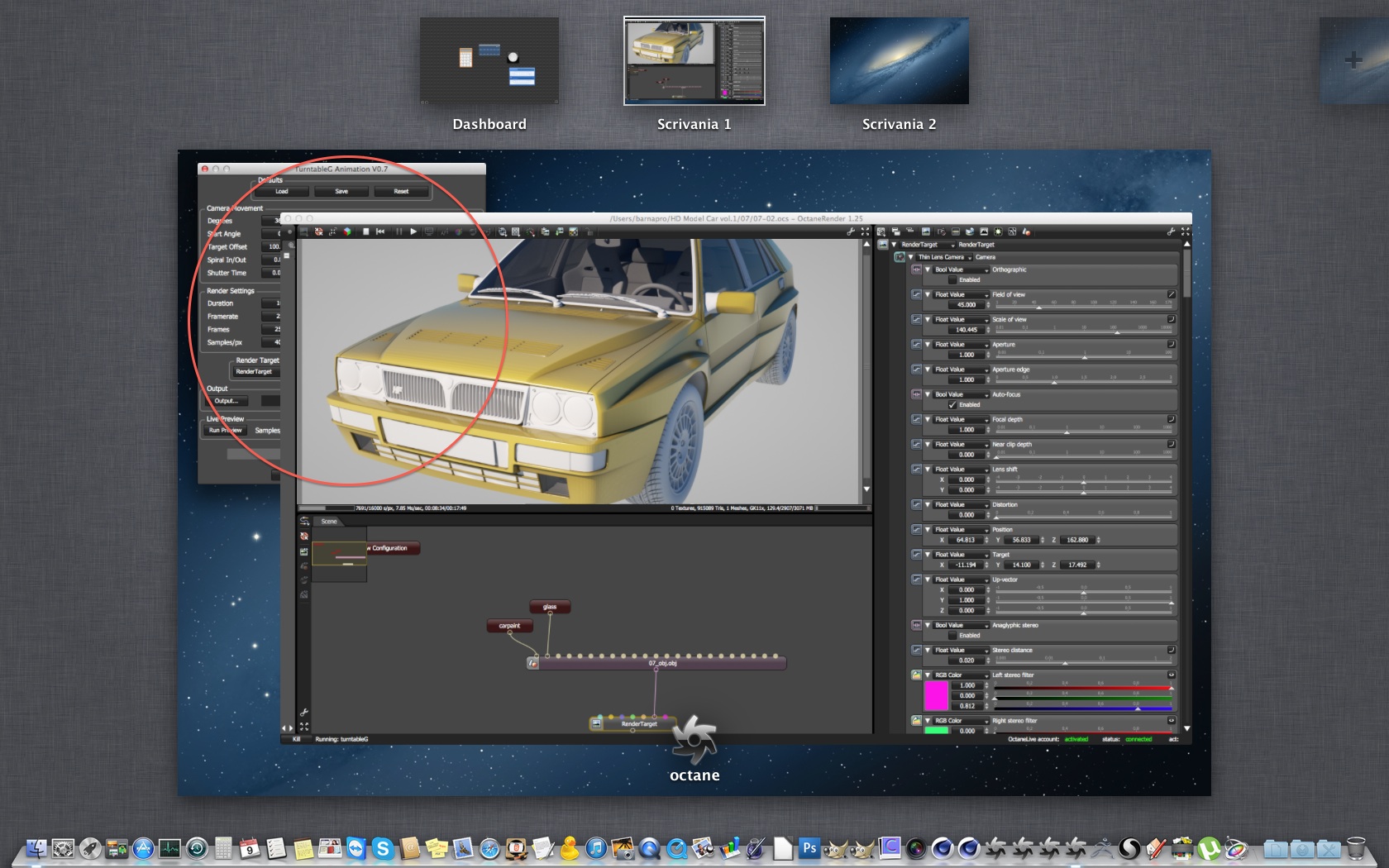

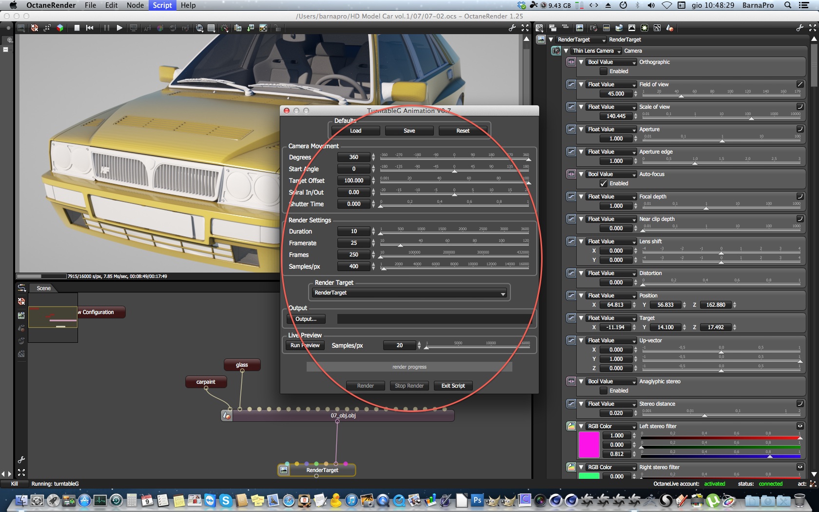

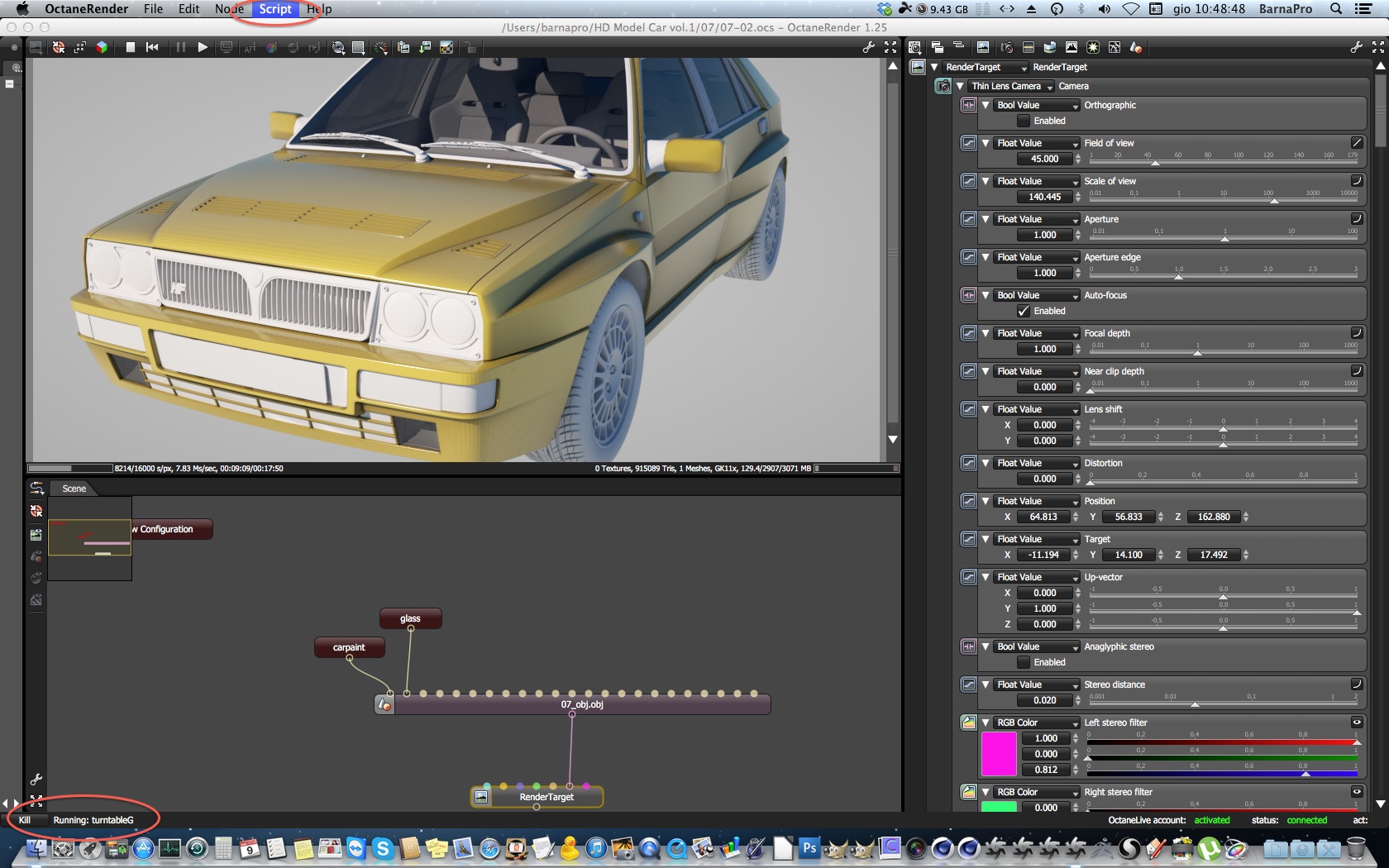

little issue with lua script and os x, if you launch a script with interface, the lua window stays always behind the octane window and it seems that nothing happen. it's necessary to click somewhere for revealing the lua window with an error sound or expose all the windows and choosing the lua one.
not a big deal but i think should be easy to fix ;)

bepeg4d wrote:hi,
ciao beppe
Oops, I thought we already fixed this, I guess not. We will look into it again.

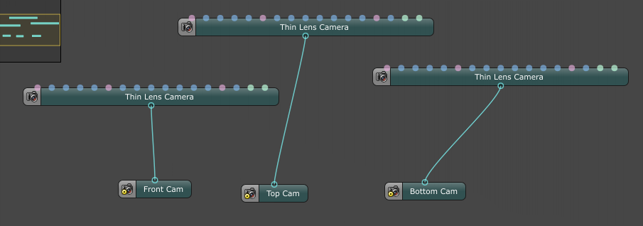

what exactly are the camera out and camera in nodes for? for that matter all of the in/out...
the problem i am having or the way i am trying to use them; and there may be another node for this that i dont know about; is much like a material macro. when you open it you have your nodes in it, but on the main scene tab you only see the one. i would like to do this with cameras... this way all render targets would connect to the one camera node, then to change the camera i would do that within the macro; just like if you wanted to change a material, just reconnect 1 inside the macro rather than in my case 3 connections every time i update a camera.

Hi there,
The magic in/out nodes are called linker nodes. The in nodes take input from outside a nodegraph (nodegroup) and links it into the node graph. The out nodes take something from within the graph to the outside. They just "link" through connections from inside to outside and vica-versa.
You would need to create a graph and create 3 camera outputs inside it and connect them to the cameras:
Camera Graph inside
Camera Graph inside
Camera Graph Outside
The new graphs are a generalized version of the old macros. You can feed in and feed out any node type you want. You can create new graphs by hand or you can select a group of nodes and do right click and select group.
I hope this makes things clear.
