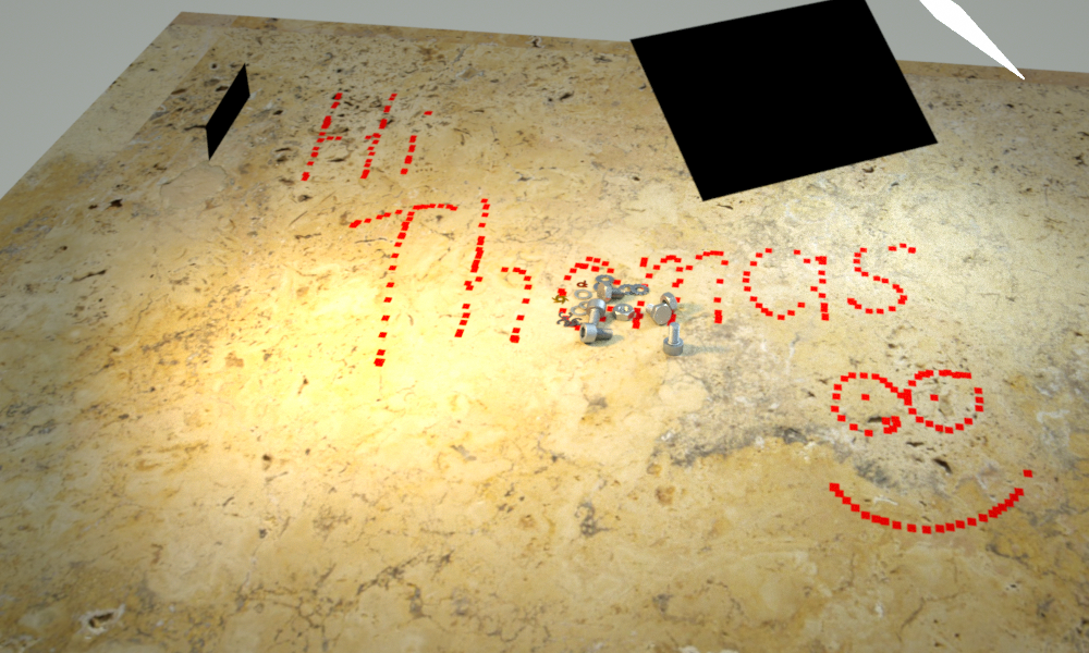

Borrowed the screws scene and the chess set texture for a wee test -
The mouse event is a little slow. Perhaps I can change a Wacom setting to make the drawing more fluid?
EDIT: seems not and I find the std win usb polling is 125hz. not sure how fast it runs with the script but 2-4x faster would be nice to have IMO. I see there are some utilities out there that gamers use to overclock polling but it seems to be a bit of a hassle for the worth of it. :roll:

pixelrush wrote:Thanks guys. :arrow: 8-)
Using my previous pc today coreduo + quadro570 + gtx460
Yeah, it's a bit slow right now. Especially for large bitmaps. The code is not really optimized, for each event, the full texture is copied again. It's just a fad of course.
cheers,
Thomas

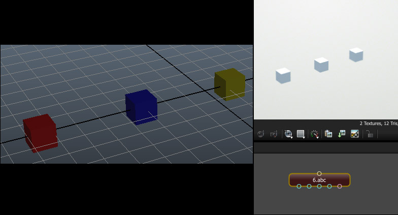

Hello,
when i'm exporting a scene with alembic from Maya 2014, i'm missing material slots. Is there something i'm missing when exporting or importing ?
here is an image showing 3 materials in maya, and only one in octane
i guess this is not a version relatet thing, i didn't use standalone in a while.
Just wanted to see how ne features ar working.
Yeah I suppose although I think that's a bit harsh :roll:
Its fun and interesting to see Lua used in creative ways.
It gets people involved, thinking of possibilities, and one thought leads to another. ;)
Don't put in in the fad bin just yet. You are doing well in your scripting promotion.
If it was just a little more feature complete and responsive it would be a neat wee demo script. 8-)
You never know it might also come in handy for some other or related Lua mission.
What I would like to see though is our turntable,linear motion and sun transit scripts finished off and uploaded as working examples and then people can go their own way and in their own time produce some script magic. At the moment although I am interested in contributing something I am not able to participate because of my skill level. :? :arrow: :ugeek:

I had the same issue when I was copying and pasting the .obj node in the node graph.
