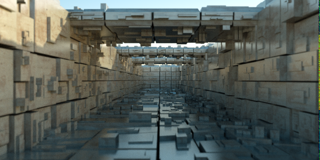

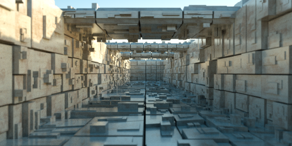

(I am just being serious about my bug-hunting eye cause I want to contribute as much as I can)
Here is a good surprise
Check out v4 vs v5 talk about energy loss! - I did it fast (I hope my exposer was not moved on any of them but it might)
