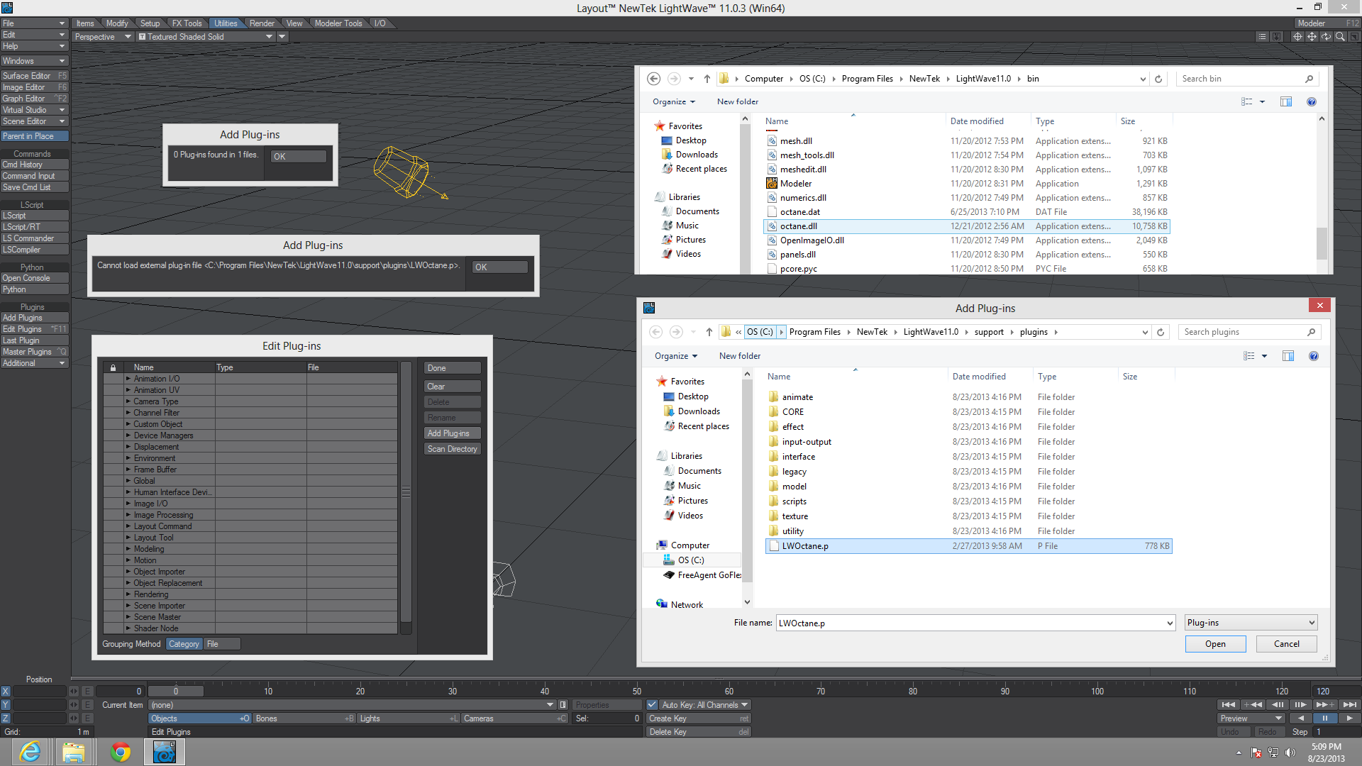

I installed Lightwave3d 11.0.3 win x64 with Octane for LW 0.9.9 beta10 x64,then with Octane for LW 1.20.1 x64 and tried to installed LWOctane.p from C:\Program Files\NewTek\LightWave11.0\support\plugins and got the same result. Lightwave on my computer setup does not want to install the plugin. Here is my screen grab of Lightwave 11.0.3.
Can you please download this custom build and try again, it is for LW11.x x64:
http://render.otoy.com/customerdownload ... LWOctane.p
Really this is a strange problem. I don't know what issue could avoid install the plugin inside LW if both are x64. Do you have other computer where you can try to install it? ... you don't need a GPU on it, any laptop for example could be fine to make the test ... it is only to know if there is something in your system that destroy the plugin install.
