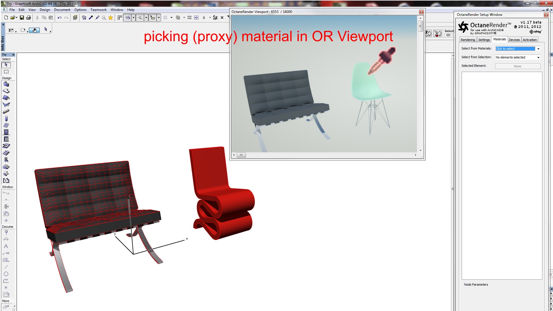

face_off wrote:
If material picker in OctaneRender Viewport would be possible
Quoting the release notes from the top of this thread...."- Added a material picking function (click on the viewport to get the material in the Material tab - AWESOME!). Enable material picking first on the Render tab". Is it not working for you?
Pau

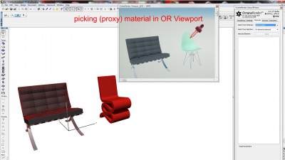

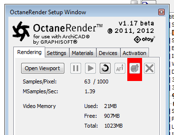

Hi Paul,
Where can I "Enable material picking first on the Render tab"?
Can I do this (see image)?
btw: I am using Release 1.17a
greetings, Jeroen

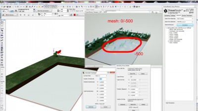

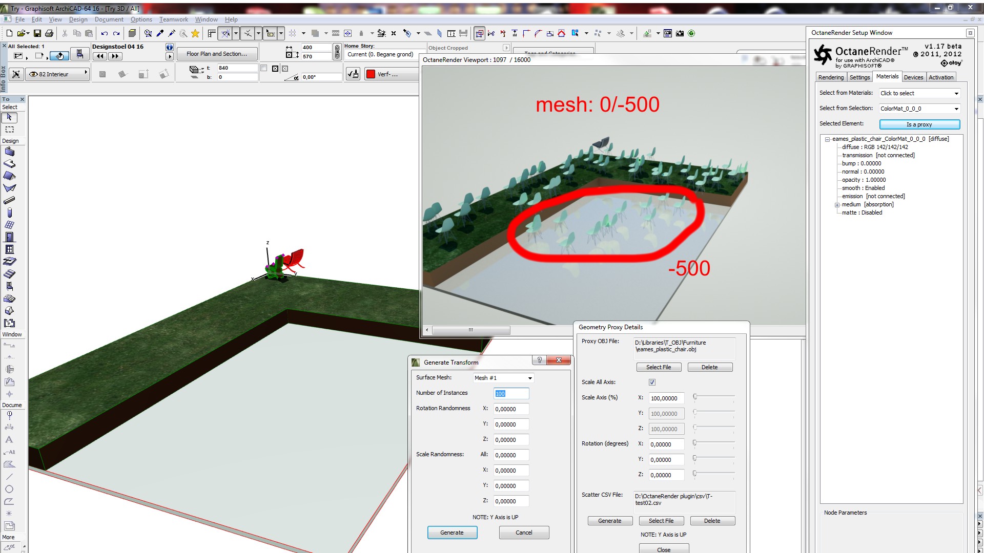

Hi Paul,
Do I always have to use a rectangle shape for the mesh?
When using an L-shaped mesh it also places proxies outside the shap.. another thing I noticed was that the 'outplaced' proxies are placed on the bottom height of the mesh.
greetings, Jeroen
Click the material pick button....
face_off
Posts: 15813
Location: Adelaide, Australia
Proxy material picking is not implemented in the version you are on, but is in the next version.
This is probably happening due to the offset not being set to 0, 0, 0. This should be fixed in the next version.
I hope to have the next version ready tomorrow.

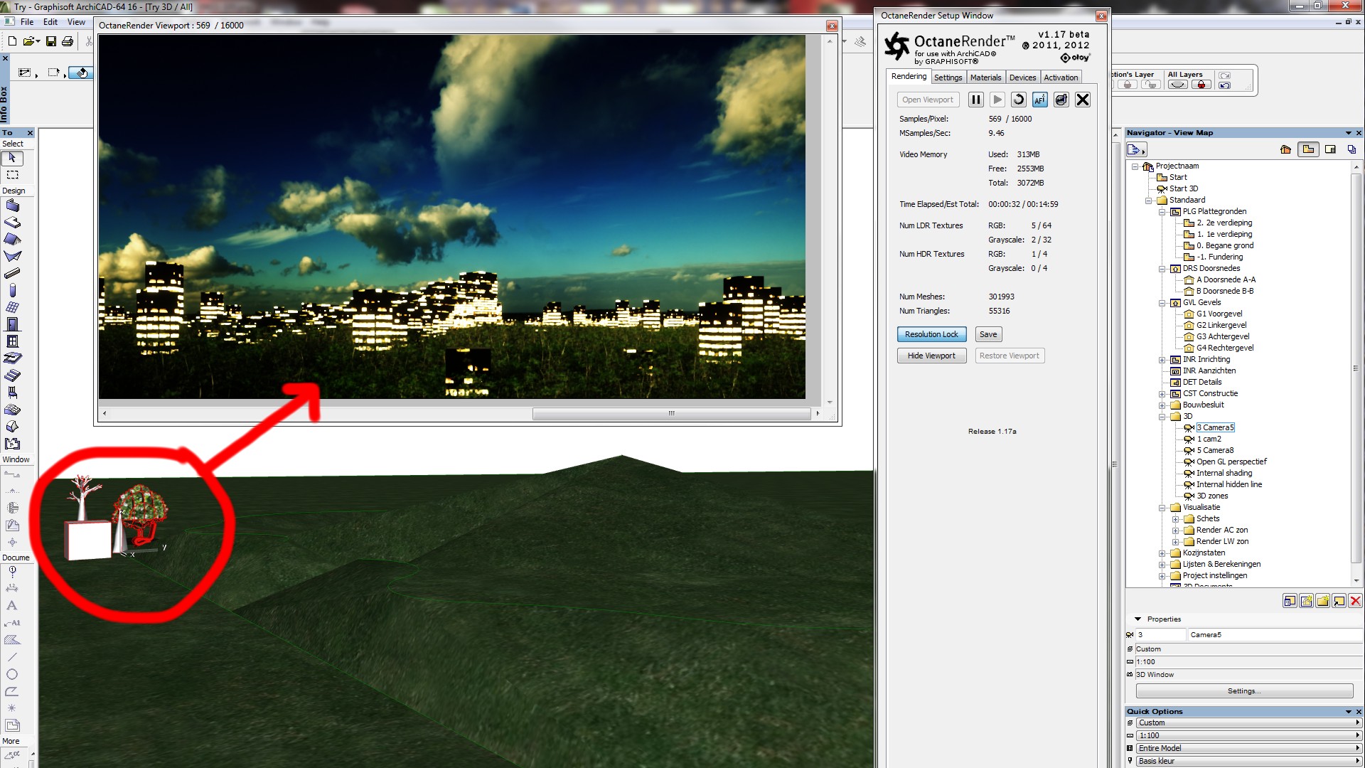

UPDATE:
I used an image for making the building with windows.
You can see the repetition of the image, when looking at the left top corner of the building.. it always starts with the same block of the texture.
Do you have any idea how to tweak this and get it more divers?
greetz, Jeroen
