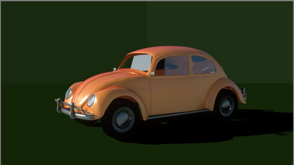

The background image option seems to be very hit and miss. It seems to work ok when your background is a small image but anything large and it just goes a bit nuts.
This is supposed to have a grassy field in the background.
(HW) Intel i7 2600k, 16GB DDR3, MSI 560GTX ti (2GB) x 3
(SW) Octane (1.50) Blender (2.70) (exporter 2.02)
(OS) Windows 7(64)
abstrax
Posts: 5516
steveps3 wrote:The background image option seems to be very hit and miss. It seems to work ok when your background is a small image but anything large and it just goes a bit nuts.
I guess you can't allocate a large enough texture in OpenGL. Have a look at the log window. If it says something that the OpenGL background texture/buffer couldn't be allocated, than that's the issue. If it is, try switching to the software viewport (in the preferences) or use a smaller image.

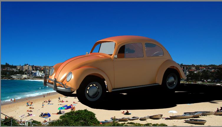

steveps3
Posts: 1118
Joined: Sat Aug 21, 2010 4:07 pm
Location: England
Ah, ok, if I set the image and then untick "Use Background Image" then click apply and the retick "Use Background Image" and apply again it seems to work.
