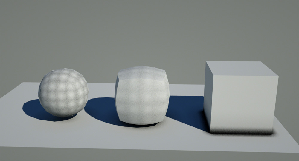

the addition of the dirt map is pretty great. i just have a hard time setting it up the right way. as soon as an object gets smooth i get dark areas around my edges. is there a problem with my normals or is there something else i'm doing wrong?

I think there is no problem with your normals, it's how the dirt texture behaves with smoothing at the time...

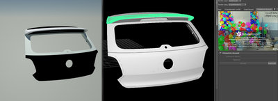

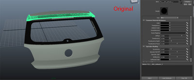

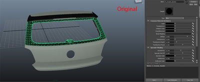

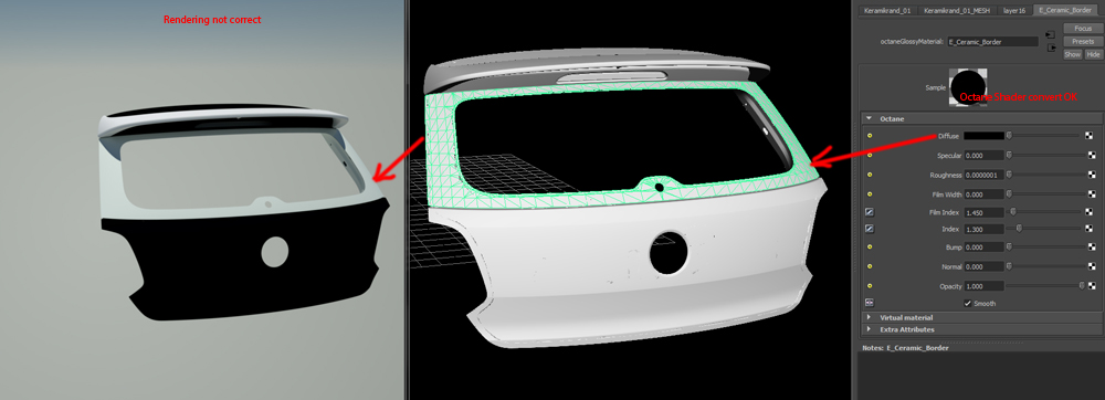

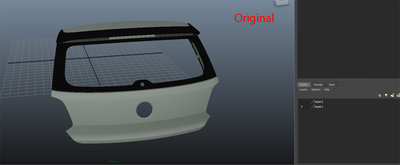

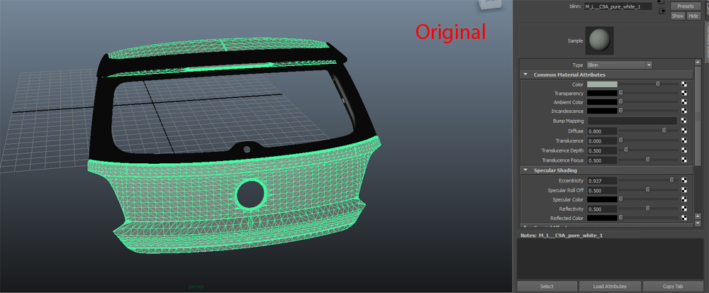

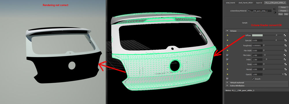

When i try to convert the shader, either automatically or manual, it doesnt work right.
It was before, in the older Version 2.58, but with thre new one i dont get it done.
I attached some screenshots to be more precise

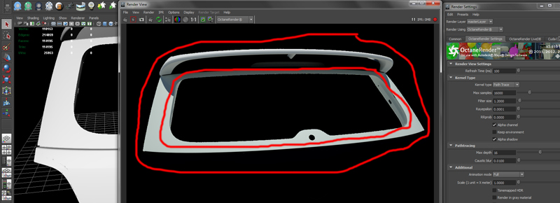

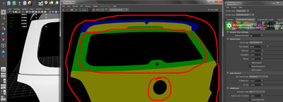

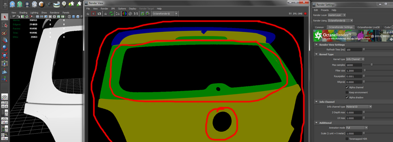

Another thing is the "destroyed" Outlines in both versions ( maya and standalone), when generate the Info and Alpha channels.
Please have a look on the screenshots.
Are you working on that issue as well?

matrix2012 wrote:When i try to convert the shader, either automatically or manual, it doesnt work right.
Can you please add some detailed comments to these screenshots - what was converted wrong, what was in original, what was the type of original shader, etc...

Hi JimStar
Please have a look on the New add Screenshots.

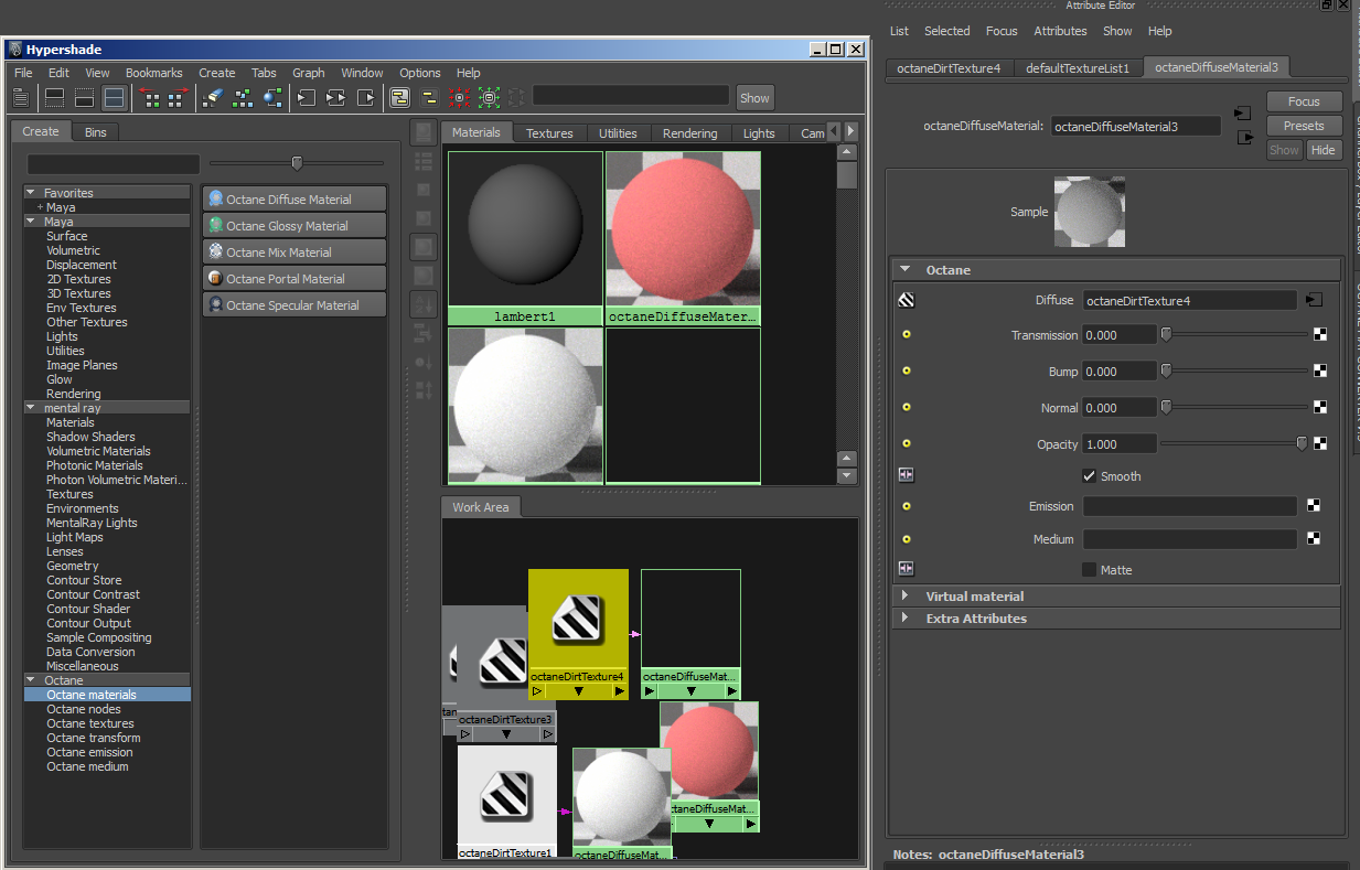

Something wrong happens with octaneDirtTexture. When I connect it to shaders material swatch turns upside down or doesn't appear at all. (Render view is closed)
