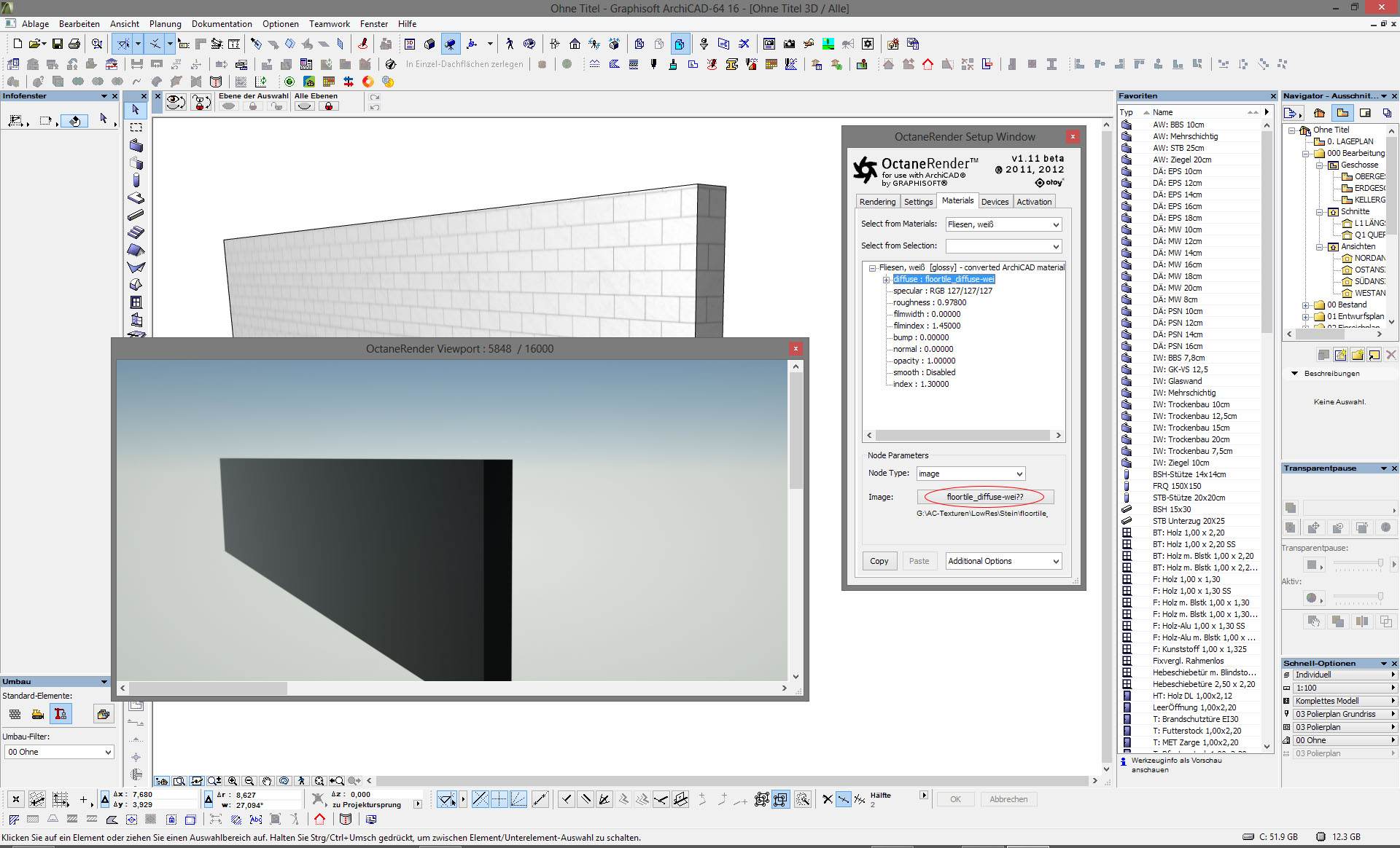

Hi Paul,
the special characters problem is still there. It seams now that the reference File paths are changed when there are special characters in the filename.
greetz
Sebastian
AMD Phenom II X4 @ 3.2GHz, Gigabyte GTX470 SOC 1280MB, 16gb DDR3, WIN8 64
face_off
Posts: 15714
Location: Adelaide, Australia
Hi Sebastian
Are there any special characters in the directory name?
If you click on the image button, does it take you to the directory that the image is in?
Paul
semi_design
Posts: 15
Joined: Sun May 16, 2010 12:34 pm
Location: Austria
Hi Paul,
yes it does take you to right directory and if you then choose the file it works!
It seams that the special character Files itself are working now, but the Filepath isn't translated correctly during the material conversion.
Greetz
Sebastian
face_off
Posts: 15714
Hi Sebastian
I fixed an issue where if the special character from in the ArchiCAD Material texture, when converting it caused a problem. I hope this fixes your problem. If not, can you pls post the texturemap into this thread and I'll test it.
You can download the updated version from the link at the top of this thread.
1.11b3
- Fixed issue where ArchiCAD materials with texturemap filenames containing special characters were not converting correctly
- Increased the maximum scene size that can be transferred to Octane (from 3 million triangles to 10 million)
Paul

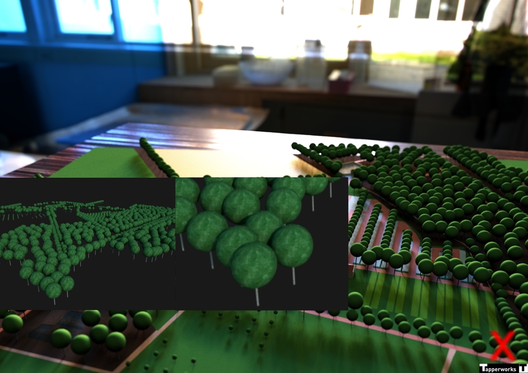

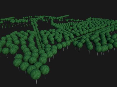

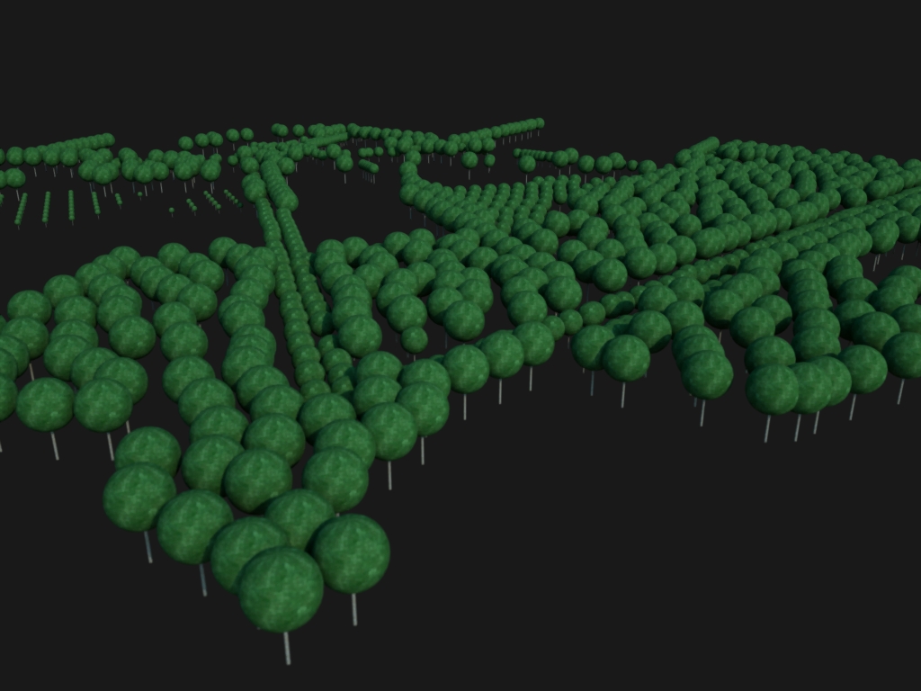

Hi Paul,
Tnx. I have adjusted my trees back to higher resolution,
and now it could load all the vertices :mrgreen:
For those who like to know numbers:
It took about 16 seconds to load the scene with 821K polygons.
I used 1167 trees, each 670 polygons: 782K,
so the trees are far out the most poly.
Nothing fancy for rendering, but the trees were supposed to be maquette simplified.
btw: the trees are modules and can be changed to more photorealistic trees easily if wanted.
:D
greetings, Jeroen
