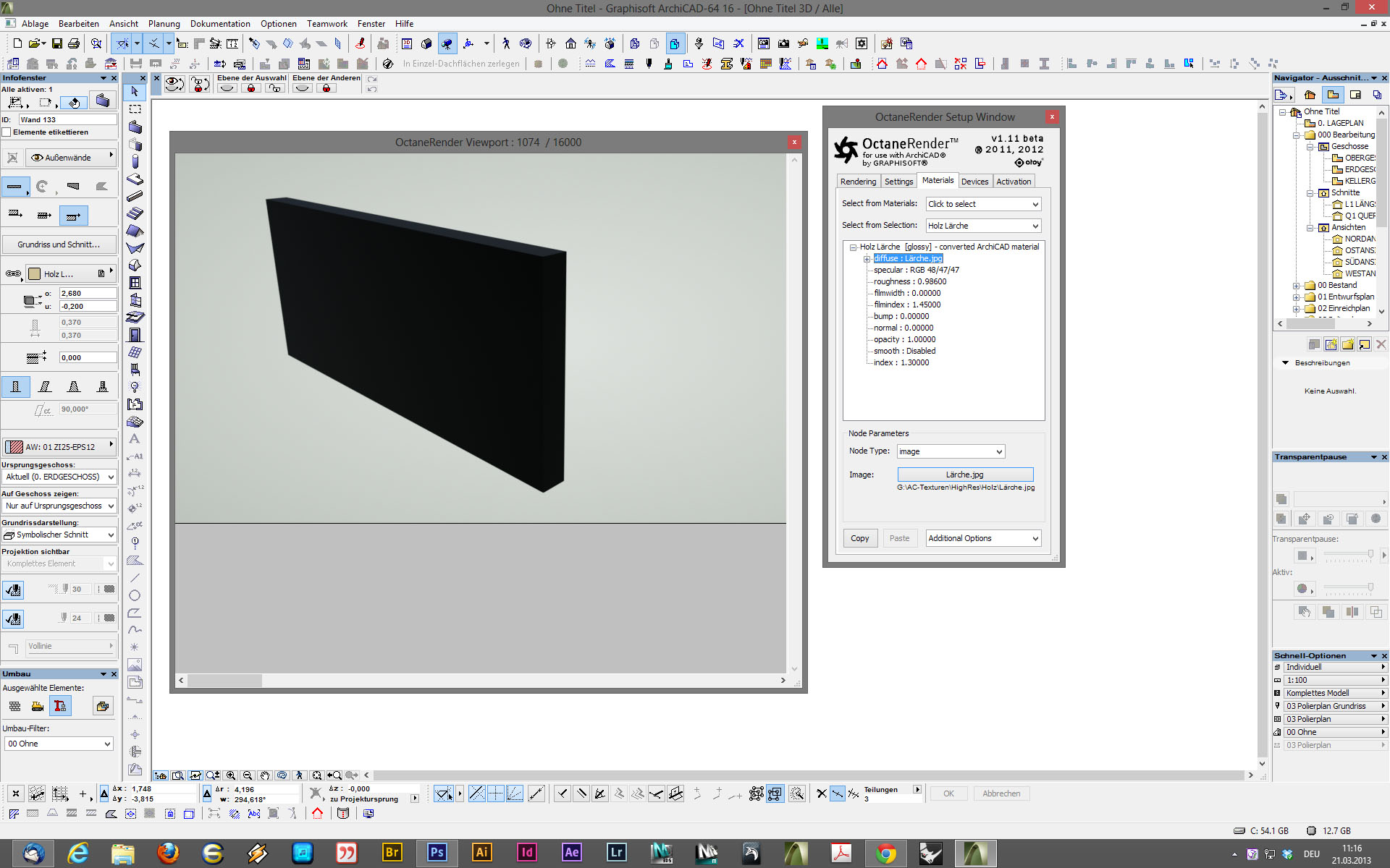

Hi Paul,
it seams that this release can't handle special characters (ä ü ö ß and so on) in filenames (textures) again.
Greetings
Sebastian

face_off
Posts: 15803
Location: Adelaide, Australia
Thanks Sebastian
What error are you getting?
Do you have a specific example of a material name causing that problem that i can test pls?
Paul
semi_design
Posts: 15
Joined: Sun May 16, 2010 12:34 pm
Location: Austria
All materials with an image texture, which filename contains a special character (ä, ö, ü, ß ...) for example: "Verputz_Weiß.jpg" or "Lärche.jpg" are not loaded into octane and displayed as solid colors.

face_off
Posts: 15803
You are right. It is not working for me on 1.02 either. Looks to be an issue with the Octane engine, although Octane Standalone is accepting these textures. I will report this to Otoy.

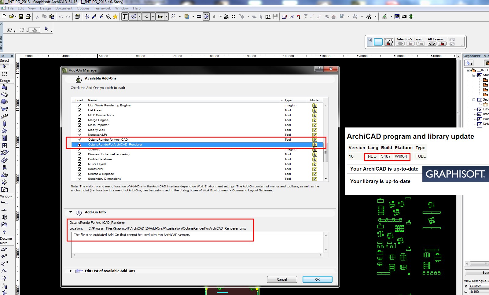

rappet
Posts: 1962
Joined: Fri Apr 06, 2012 3:57 pm
Location: The Netherlands
Hi Paul,
As you can see I got un incorrectly installed plugin of 1.11.
Immediately reinstalled 1.02b and that was OK again.
greetz, Jeroen

face_off
Posts: 15803
Hi Jeroen
What is the date/time and filesize of your C:\Program Files\GRAPHISOFT\ArchiCAD 16\Add-Ons\Visualisation\OctaneRenderForArchiCAD_Renderer.gmx file pls (after installing 1.11b).
Also, pls re-install 1.11b, reboot, and try again, just in case something is still running.
Paul
face_off
Posts: 15803
I've done some more investigation into this, and it appears the plugin is not correctly encoding the filename correctly. I will hopefully have a fix in the next day or so.
Paul
