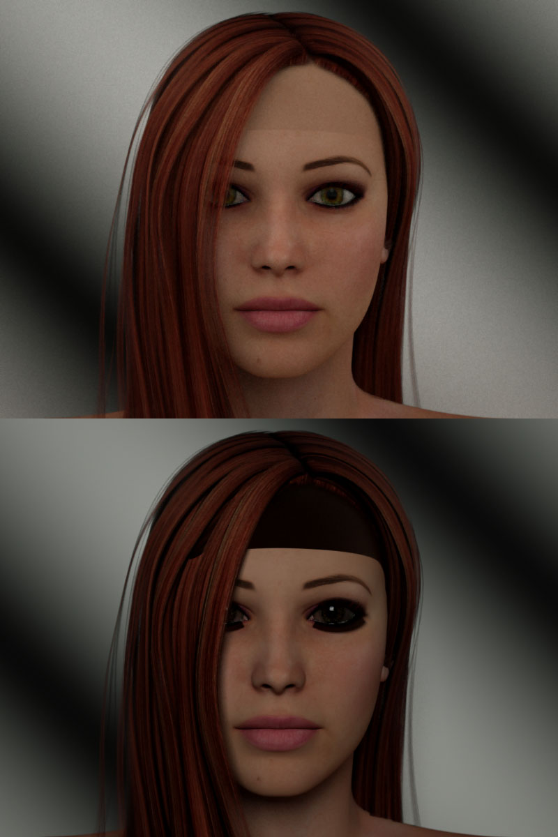

Today I was doing some tests with hair and ran into a problem.
In my scene I have a V4 with the "Yoanna" hair conformed to.
A random background prop behind the figure.
The attached picture of two quick PMC renderings will show my dilemma.
In the upper picture, the light comes from the environment and from an emitting one sided square together.
There the "thing" on the forehead is already visible.
In the lower picture, I tuned off the environment light and increased the light from the emitting square significantly.
The result is ... heh .. even more noticeable.
That "shadow" thing is exactly, where the cap of the hair goes along.
I used the trans.map of the hair, plugged it into the opacity node with the power of 1 and gamma at 1.
(Same goes for the eye lashes as well)
Can anyone please tell me, why there's still this shadow across the forehead?

You've also got a problem with her lashes on the bottom shot.
I'd need to see you settings and the scene, but at a guess, perhaps the hair cap is sharing the same vertices as her forehead? This will impact Octane's ability to render transparencies. The give-aways that this might be the issue is her eyelens material has blackened out her eyes.
The easy fix is to drop the rayepsilon in the render settings, however the Poser default is 0.00001, which is about as low as you can go. Regardless, double check your rayepsilon and see if increasing/decreasing it helps/hinders.
Also, specular materials, the light transmitting through the "glass" can be given a different priority to the direct light - this is a setting in the PMC kernel.
So in summary, I think this is resolved through the kernel settings, but I'd need to see you exact settings and materials to provide any more info.
[EDIT] If could also be your emitter settings. Is it a single poly emitter? Which prop did you use for the emitter? How you looked at Wim's post in these forums regarding setting up emitters?

Hi Erick - try converting the transmapped parts (like the eyelashes and skullcap) to "glossy" rather than "diffuse".

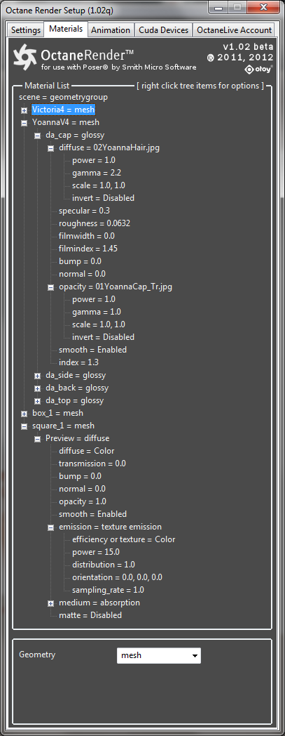

That's basically it.
The settings for the hair and for the emitting one sided square, which is in front of the figure (V4).

With this I meant, that's basically what's in the scene. With the hair and emitting square node-settings opened.
Sorry for the confusion!
Unfortunately the problem still is the same. The transparency part still doesn't render properly.
I tried it with different hair figures, by different vendors, and all of them, which are having this kind of a cap, the outcome looks like in the above attached pictures.
I must be doing something completely wrong here LOL :C

In that case I think the normals may be overlapping. I've had the problem before, if you can offset the cap a tad so that it's just 1 mm outside of her head it may fix it.
I've seen this happen to clothes too.
Basically the outside of the cap is occupying the same space as the outside of her head, they can't share space.
But I could be wrong about your problem, but it really seems similar.

Overlapping vertices indeed was the culprit!
As by Paul and now by larsmidnatt mentioned, it was because vertices of head and cap were sharing the same space.
As a test, I pushed a few vertices of the cap back into the head of the V4 figure, with the morphing tool, and rendered it.
And indeed ... In the areas, where I pushed back the verts, the render went well, whereas the areas, which it didn't touch, the outcome was as in the previous renders.
Thanks for the help!
