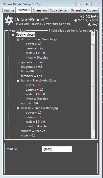

Maybe I misunderstood about glossy I thought you had to set the tab to glossy and then change the default settings here is my default settings what needs to be change on here to achieve translucent effect on hair and to make it more realistic I probably misunderstood/
From the default converted hair material, try roughness 0.3, filmwidth 1, and I think I used opacity at 0.8 or 0.9. Bump power 1. Then adjust the /amount/ of specular with the specular "color".

And still l bit confused about the settings sorry about this is I said in very new to this forum
"roughness 0.3, filmwidth 1, and opacity at 0.8 or 0.9. Bump power 1"
The only way I see these settings is converting the default from diffuse to specular. I take it this is correct
Seeing enclose screen dump?
as Default i only see power,gamma,scale,ray_step
You need to set the material to glossy.
There you have a roughness and a film-width channel. Opacity and bump channels are present in all material types.
