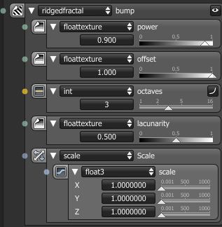

i attach a picture to show you what i mean for the float fractal texture values ( exept error from my side, the feature doesn't exist in the poser plugin )

,face_off wrote:* do you plan to add "float 3" parameter for texture scaling ?

You are right - I will change this the next time we are updating the manual.About this pdf, i think the definition of the roughness inversed ( page 43: the bigger it is, the less reflective the object is: it is written the inverse )
Good point (I thought you were originally referring to images). I'll need to look into this - I think it would be better to have that particular scale automatically set to float3 rather than float (although slightly less convenient to adjust). There are some other materials like this (checks, marble, sawwave, sinewave, trianlgewave, turbulence). I will change it in the next version.i attach a picture to show you what i mean for the float fractal texture values ( exept error from my side, the feature doesn't exist in the poser plugin )
