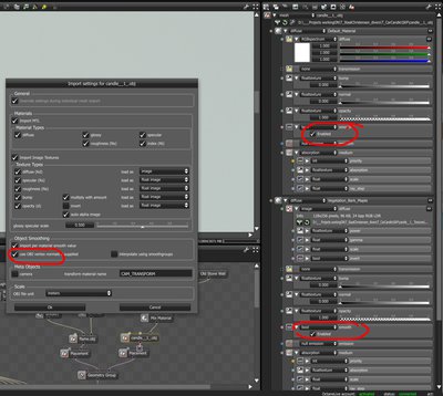

Thnx guys for your responds trying to help :-)
@Face (and other who like to try)..
the original SKP is attached..
@roeland

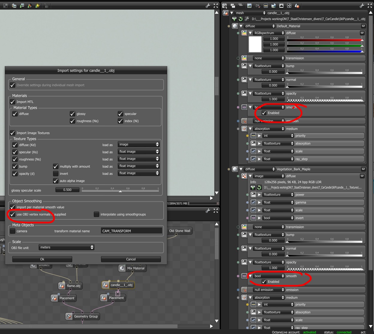

I checked the "use OBJ vertex normals if supplied" and it is enabled
@steveps3
I checked the smooth enable, but I don't dare to bet cos maybe I missed oa setting :roll:
@kavorka
I tried to check the model and could not see if the vertices are not welded together
the settings
the settings

Have you tried importing the mesh with the "interpolate using smooth groups" option there?
Else, I would suggest to import the .obj in Blender, clean the mesh, enable smoothing and then use Blender exporter to export to Octane.

matej wrote:Have you tried importing the mesh with the "interpolate using smooth groups" option there?
EDIT: typo
Yes i tried, did not help.
And yes, good suggestion, i'll try to find out if it is possible to clean mesh in c4d or in sketchup.
