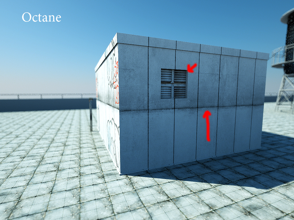

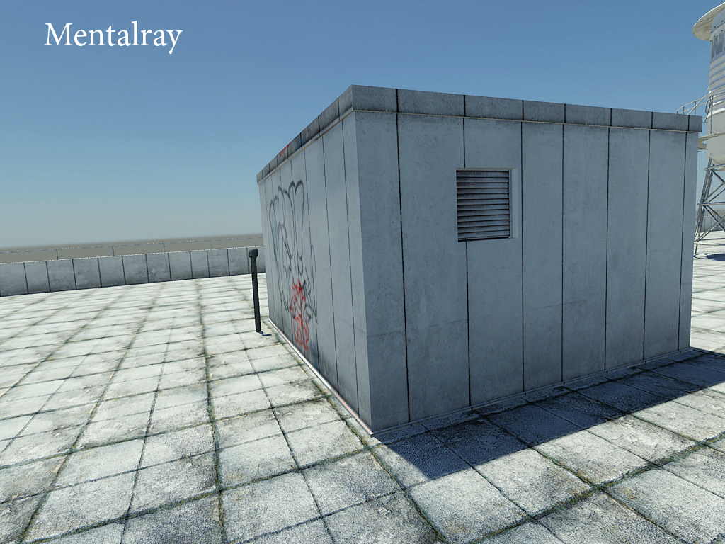

poor export, in a scene made all the textures modifier UVW Map (3d max)

Have you used the bitmap settings? Offset and tiling?

Yes bitmap textures

yeah I ran into that as well, I dont think the bitmap offsets/tiling are taken into account at all on export, just the bitmap names really

as i said in your other post you can adjust tiling by putting a float2 node on the 'scale' of your image texture, then you can tile in both u and v texture coordinates.
