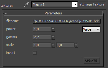

I karba,
Isn't it possible to add an update button on the texture parameter panel ?
- Attachments
- update button.jpg (52.01 KiB) Viewed 4617 times
