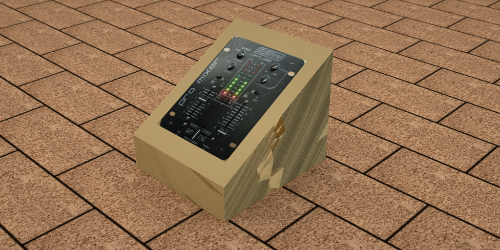

Stephan3D wrote:@ Lemonnado
I have the same problem with my first UV mapping test... :?
The normals are right?
To test it, use a sphere, export it, sunlight on in Octane and play with Material smooth on/off.
face
http://vimeo.com/user2509578

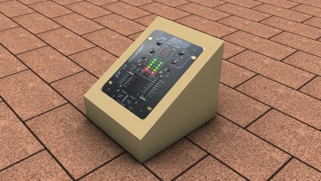

Stephan3D
Posts: 12
Joined: Tue Jun 01, 2010 11:59 am
I check my normals in Cinema...ok
>...play with Material smooth on/off.
That is it. Smooth off, all OK :D
