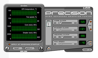

thanks but it keeps crashing with snow even with a clock at 450 especially when i try to change for a higher resolution.

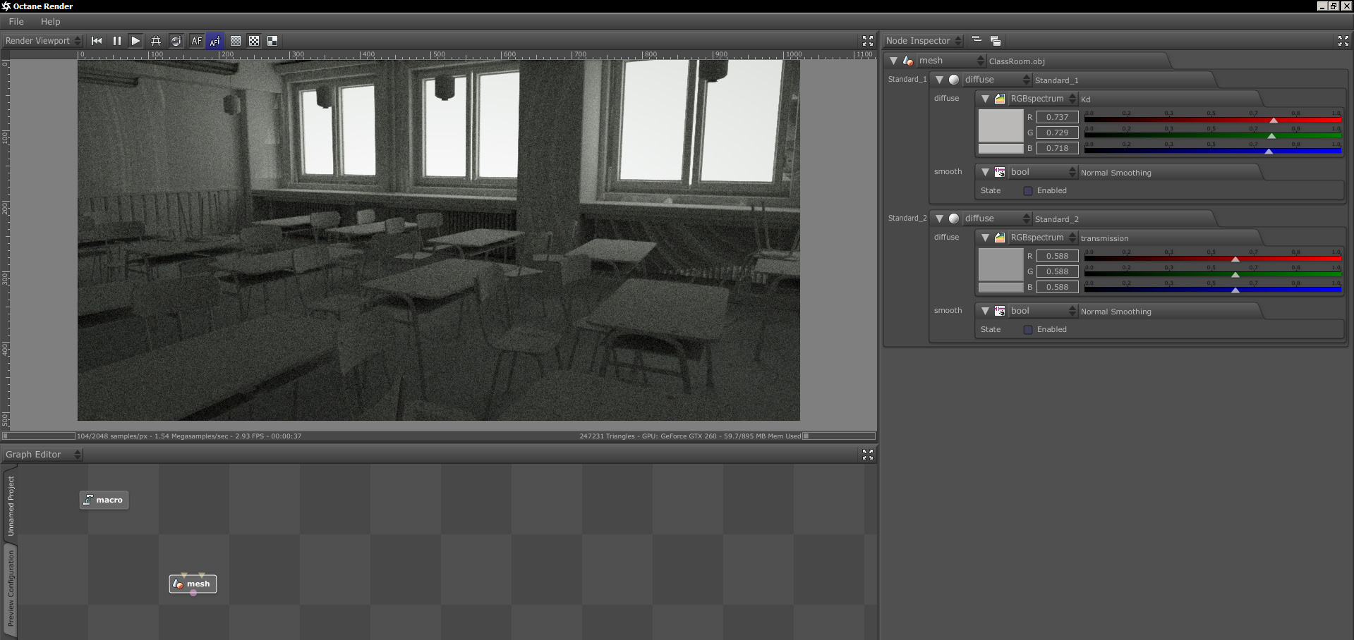

i downloaded the file you sent me and it works fine here.
the dimensions are wrong. (it's huge, you might have to change the import obj preferences and translate from the correct dimension to octane 1 unit = 1 meter)
it has 2 materials and one of them import as specular/glass, i changed it to diffuse.
the ring artifacts on the walls are precision issues due to the fact that the classroom is kilometers large.

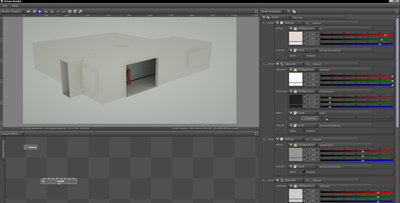

It seems the problem with my scene was the scale, it was converting cm to meters so the scene was way too big.
Now it's more stable
When i change the resolution the render view goes off screen, is there a way to center it back ?

i loaded it in, here's a shot.
you should change your units.
start up octane, then go to File -> Import Preferences.
change the units to centimeters,
then load in the OBJ.
