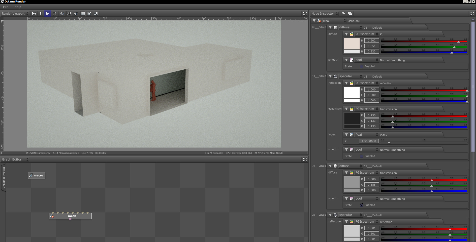

It seems the problem with my scene was the scale, it was converting cm to meters so the scene was way too big.
Now it's more stable
When i change the resolution the render view goes off screen, is there a way to center it back ?
Win7 x64 - I7 920@4Ghz - 6Go DDR3 - GTX470
