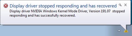

Are you sure only octane is crashing and not your graphics driver? On windows 7 you'll get a recovery system try message like below. There's a Windows feature™ that kills Octane, taking the graphics driver with it if your FPS counter goes below 0.25 (it thinks it's stalled and needs to recover).sam75 wrote:octane keep crashing leaving snow/artefacts on my screen
Edit: This doesn't seem to be the problem your having. Anyone experiencing this issue see the following post. http://www.refractivesoftware.com/forum ... ?f=9&t=145
