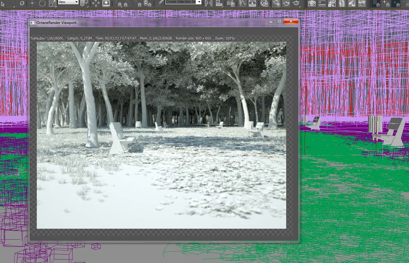

Okay first quick run with one of the free ForestPack Pro scenes rom itoo website.
It works very well. Octane Material Converter generated a lot of bad materials with glossy bark and whatever so I rendered untextured.
Around 227 Million polygones (is it billions in english..dunno).
Problem with viewport: 3dsmax has massive lags so I dont see any icons from the OCtane Viewport anymore. I background render with oe GPU. The other one for GUI.
Render Button works nice. So I can use it.
