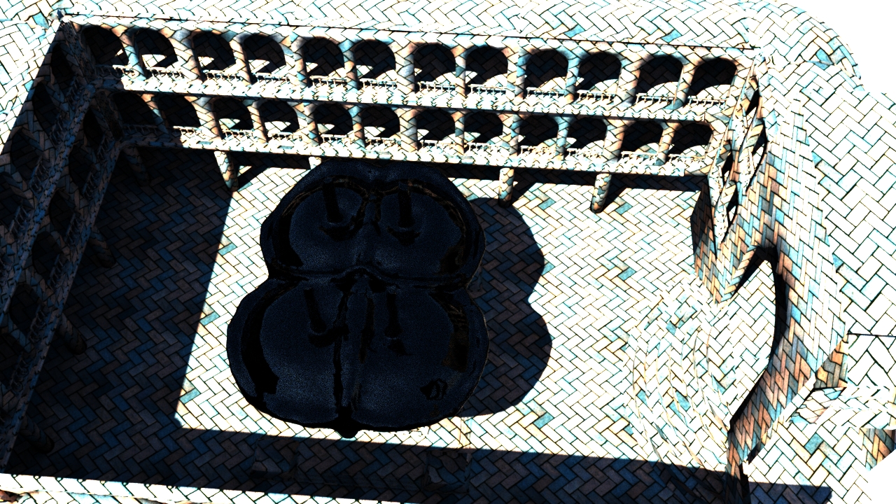

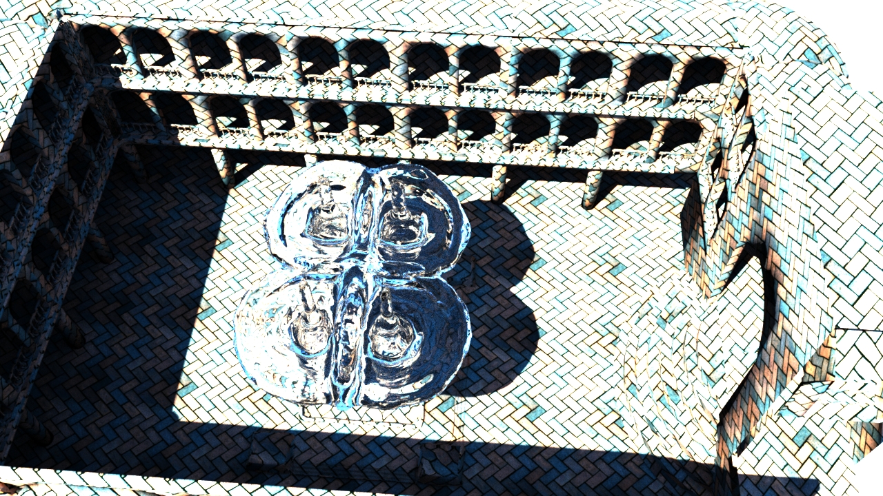

i haven´t been able to render a full animation yet, because the renderer get´s stuck. it simply just stop at some point and i have to restart it, very annoying really. and something strange happens to my render, an example here is i have some clear water shading going on, and then suddenly in one of the frames changes the water to something that looks like dark deep ocean water. another example is that i get a completely overexposed image.
i´m a little disappointed about this plugin, but i will try and get along with it and hope for quick bug fixes and updates. :)
