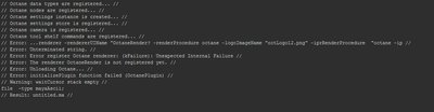

thomaslee1312
Posts: 23
Joined: Thu Dec 01, 2011 3:09 am
Hi guys.
I wanna know why my Maya collapsed when I load the plugin.
I am using Maya 2011 X64

thomaslee1312
Posts: 23
videoprice wrote:
thomaslee1312 wrote:Hi guys.
You need to purchase separate octane license for maya
Yes, I have done it. I have got both licenses for the standalone and the Octane for Maya
JimStar
Posts: 3852
Can you describe step by step what you do? And some screenshot of what is in Maya's console?

thomaslee1312
Posts: 23
here is the console feedback
isn't it registered like octene render for max, after I load it in Max then register?
I have register the standalone version in my computer and it works well.
JimStar
Posts: 3852
thomaslee1312 wrote:isn't it registered like octene render for max, after I load it in Max then register?
Yes, it registers like Max plugin. I think it is some little bug bound to OS localisation... Can you say, do you have the localised version of OS? Or localised Maya?..
