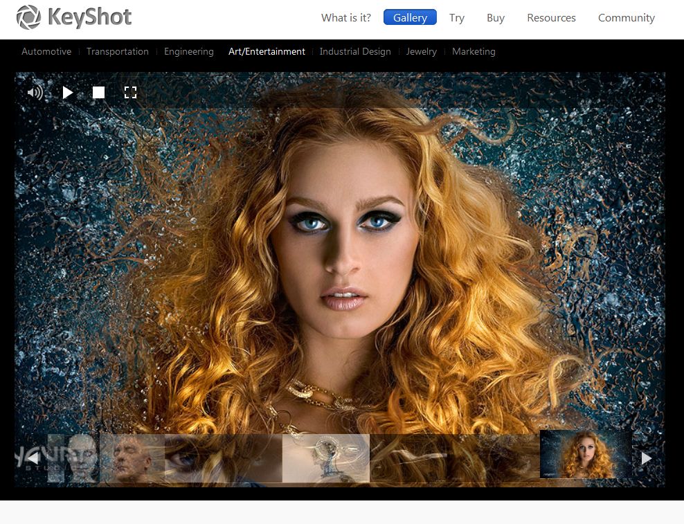

Elvissuperstar007
Posts: 2617
Location: Ukraine
KeyShot
