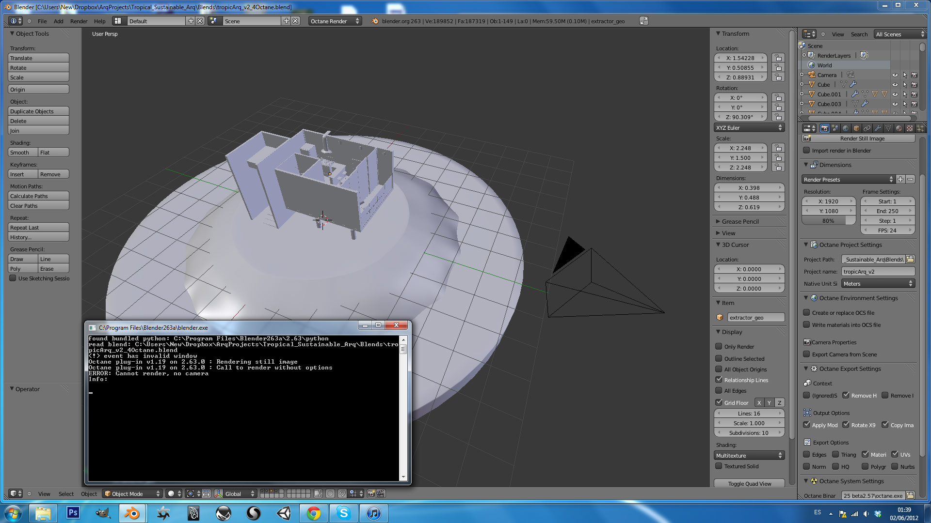

I have a problem with thte exporter
Log says: " Cannot render, no camera." but the camera is stilll there.
I tried checking and uncheking the "export camera from scene" buttom. still nothing happened
I deleted a camera and created a new one, I didnt back up my old file with the old camera. So don´t know what to do.
After that i couldnt render still image to keep editing materials in octane.
I am stuck now.
I installed now the 1.19 version of the plugin to see if that would help.
How should i fix this? Thanks

Your camera is not attached to your scene. Please switch to blender render and select 2nd tab (there's a bug in 1.19 preventing you to access scene parameters). From there ensure you have your camera selected for your scene.
I've attached v1.20 for getting around the setting display bug, but you still have to look at your scene settings.

omorenof
Posts: 11
Joined: Wed May 23, 2012 10:25 pm
Location: Campeche, Mexico
Thank you very much you saved my day
really appreciate it it worked :D
