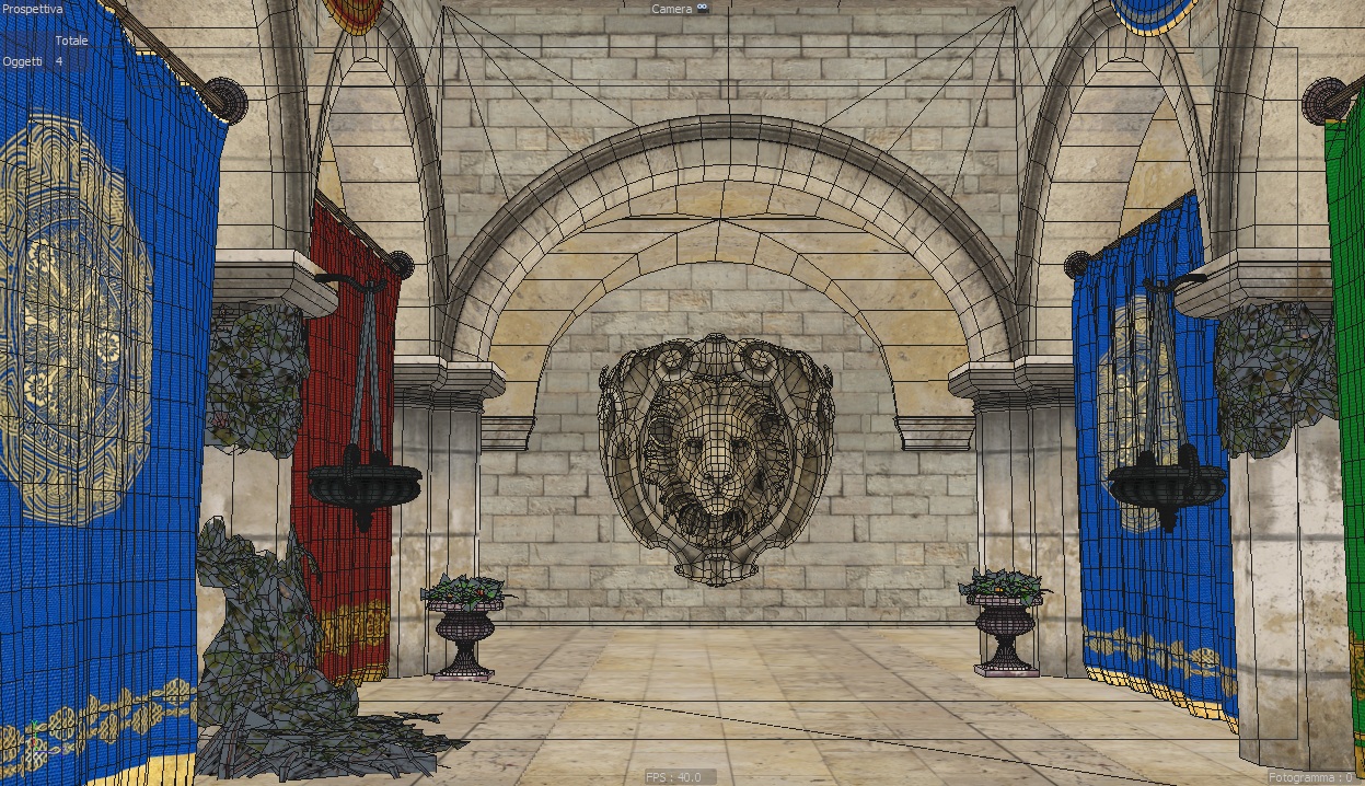

Hi guys, I have a geometry issue with the Sponza model... I checked geometry, normals, phong's angle, bool smooth in Octane but nothing seems to solve this bug.
See the attached images. C4D R13
Thank you in advance!

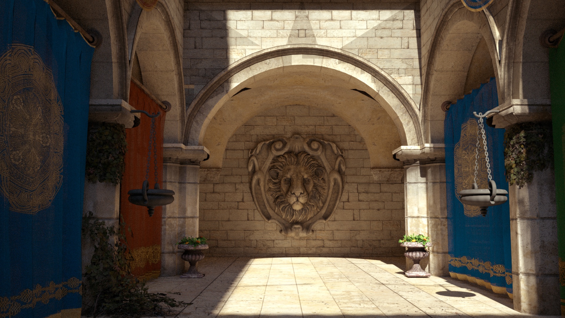

Hi guys, I did a second version using the "triangulate" command... to convert any quads into tris. Then I exported to octane... it seems that the problem is still alive
See the attached images... by going deeply, I saw that also materials are affected by this issue...

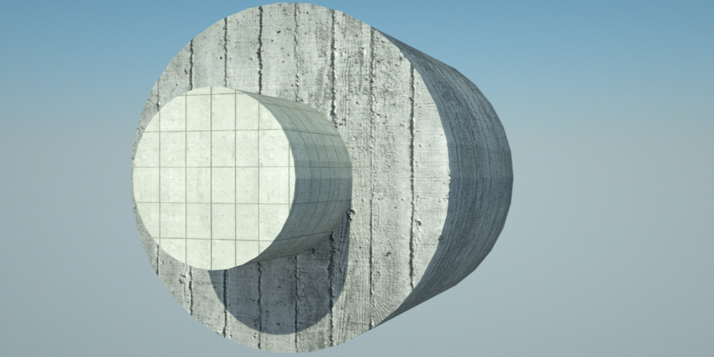

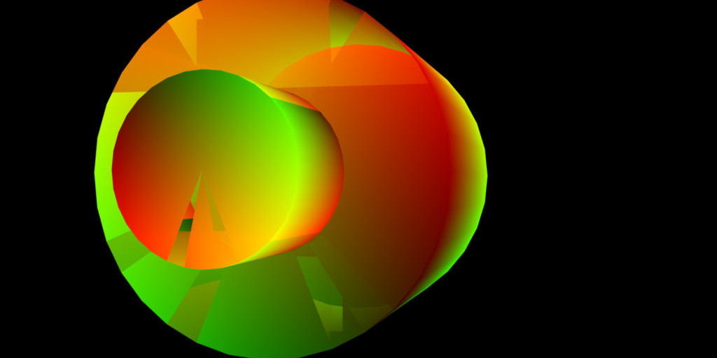

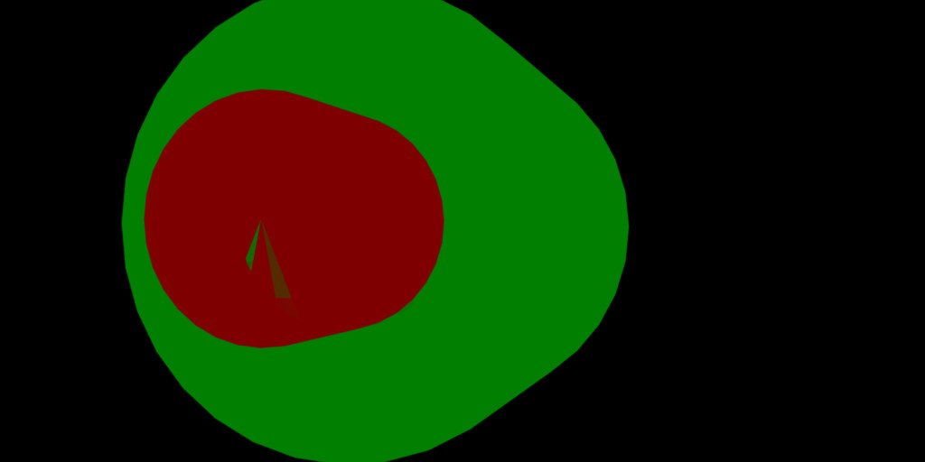

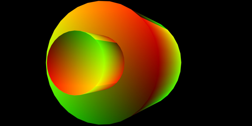

Hi Guys,
This is what i was taking about when i have problems with geometry that is too large.
I made a simple 2 cylinder model to test. I made it big enough to get problems then scaled the exact same thing down by a factor of about 150 then re-exported from blender, updated the obj in ocatane, re-arranged the camera to get the model into view again and all was happy.
Cheers
FooZe
Cheers
FooZe

Thank you for the answer FooZe... Do you think it's a plugin issue or an Octane obj import failure? (.. I'm not very happy because I don't want to do all those crazy steps to reach a very standard result!)
