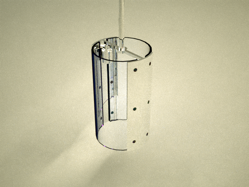

On a different note, I'm trying to utilize Octane for some basic product renderings and I am still struggling with getting the lighting correct. I'm providing environment lighting through HDRI and utilizing Octane lights for specular/glossy highlights on the product - however the rendering look's nothing like it should (atleast what I'm trying to achieve). Attached I've provided a shot from Octane and one from VRay. Any advice is much appreciated.
V-Ray Product Rendering
Octane Product Rendering

There are some settings you could try:
Set Camera Response to Linear
Set Vignetting to 0
Mesh Preview Camera aperture to 0.01 (smallest level)
Cheers, mib.

If you set the camera response to linear, don't forget to set the gamma value to 2.2 (it should match your monitor gamma).

Would it be possible for you to take a look at this file? Many thanks!
roeland
Posts: 1823
You have a different material setup in the two renderers. For instance in the Octane render the pole is made of glass while in the V-Ray render it is made of metal. For a render like this you also need to make sure the maximum depth setting in the kernel is high enough.
The environment needs to be an latitude-longitude map. Cube maps don't work in Octane.
Roeland

The glass pole was corrected in a later version, I suppose I sent one iteration back. I was pretty sure that the HDRI is spherical and not angular/cube based. Will give some other options a try - will take it back to basics where I'll utilize the HDRs provided with the Octane Demo pack. Thanks for the help!
