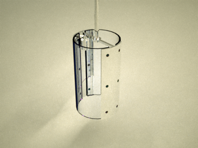

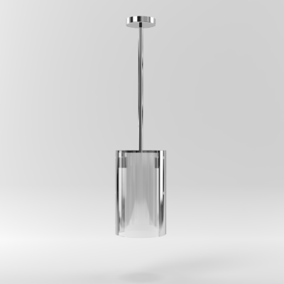

On a different note, I'm trying to utilize Octane for some basic product renderings and I am still struggling with getting the lighting correct. I'm providing environment lighting through HDRI and utilizing Octane lights for specular/glossy highlights on the product - however the rendering look's nothing like it should (atleast what I'm trying to achieve). Attached I've provided a shot from Octane and one from VRay. Any advice is much appreciated.

There are some settings you could try:
Set Camera Response to Linear
Set Vignetting to 0
Mesh Preview Camera aperture to 0.01 (smallest level)
Cheers, mib.

You have a different material setup in the two renderers. For instance in the Octane render the pole is made of glass while in the V-Ray render it is made of metal. For a render like this you also need to make sure the maximum depth setting in the kernel is high enough.
The environment needs to be an latitude-longitude map. Cube maps don't work in Octane.

Thanks Roeland,
The glass pole was corrected in a later version, I suppose I sent one iteration back. I was pretty sure that the HDRI is spherical and not angular/cube based. Will give some other options a try - will take it back to basics where I'll utilize the HDRs provided with the Octane Demo pack. Thanks for the help!
Kind regards.
