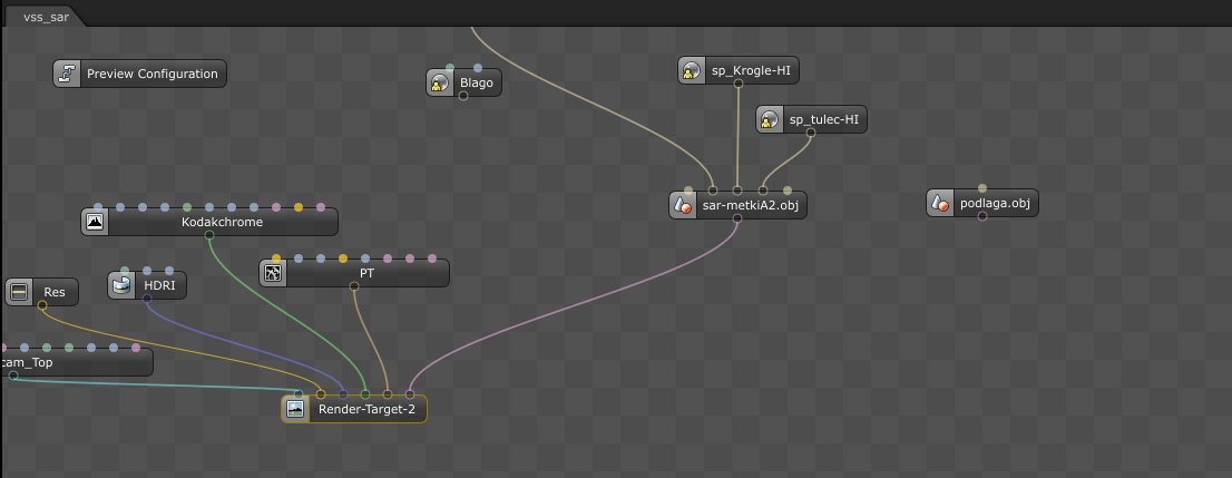

I have a small feature request regarding render targets. I have set up the scene with a custom render target and pluged the mesh into it, like it's visible on the screenshot:
The first problem appears when you click on the mesh node - it actually starts to render the render target that is set up in the "preview configuration", instead the one that the mesh is plugged in. Ok, this is not really a problem, cause you can click on the custom render target node to start it. But if you run Octane from the command line, you can't render the custom one, because Octane always starts the one that is defined in the "preview configuration". This is probably a bug or something, because it should render with the settings that are defined in the render target where the mesh is plugged in.
This lead to the feature request: it would be really useful if we had a --render-target switch which would tell Octane which render target node to use for rendering, similar to the --mesh-node switch that tells which mesh to render. This way we could automate rendering of some scene with different settings (camera, resolution, etc..), without the need to be behind the computer & manually start render jobs or messy tricks like duplicating .ocs files.
