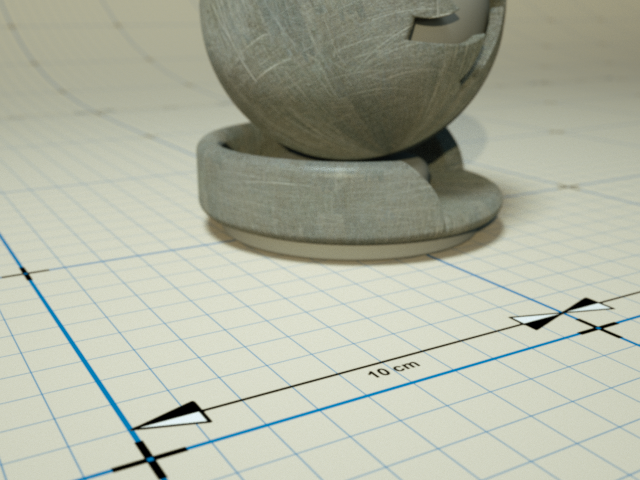

please take a closer look at the LiveDB material editor that you can see in this screenshot:
Material editor of OctaneRender with scale
As you can see it has a scale that says "10cm". The purpose of this scale is to define how the material should look like, how large it is. SketchUp uses units, e.g. meters for its model. So it is clearly defined how a material has to look like when applied to a SketchUp model. It certainly must NOT take any UV-map-scalings into account as in your first two screenshots, because the size of the texture and its scaling is already part of the material description. I certainly know that the scaling can be changed in a material, but it doesn't make sense to change it, because it already defines how it should look like relative to the 10cm scale. So there seems to be a bug in OctaneRender.

dom wrote:As you can see it has a scale that says "10cm".
The UV scale is dependent on the object rendered. On some objects the unit interval (0.0–1.0) spans one meter, on some objects it spans much more, on some it spans much less. There is no way of taking that into account on the material ball. On the material ball we have chosen to make the unit interval span about 2/3 of the circumference of the sphere.

sorry, I think you misunderstood me. I don't want the material editor/sphere to be changed, it is fine as it is. But the material editor is used to define a material. You can see in my screenshot of the material editor how the material should look like. And when applied to my model, it doesn't look this way in one of the two cases because it is incorrectly scaled by OctaneRender.
In the SketchUp exporter you can define the size of a unit, it is usually "Meters". And I think there is also such a setting in OctaneRender, which was also set to "Meters". Additionally it isn't the problem, because if you look at my screenshots, you can see that the *same* material was scaled with two different scales in the *same* scene. This shouldn't happen. It is a material, not a texture.

The problem is that the UV scaling is dependent on the mesh, and it is not exported from the application. For instance in your living room example 1 unit spans the entire room when you use the floorplan (it needs to, because you don't want to tile the floorplan), but 1 unit spans some fixed distance when you use the wood texture (assuming it is tiled). That is why the stone texture gets scaled differently for those two cases. Octane has no way of knowing the unit length for the UV coordinates it is getting.
The cm scale is mainly there to scale procedural textures.

There are two systems for sampling textures in Octane. At the moment they are tied to the type of texture used.
The leather material uses a procedural volumetric texture. These are sampled in Octane using the position of the point. Therefore the scaling of this texture is dependent on the object having the correct size, and it is possible to compare the this material with the grid in the material preview.
The bricks and the wallpaper use an image texture, which is sampled with the UV coordinates from the mesh, so the scaling of this one depends on the UV mapping and is independent from the size of the object (but note that an application may adapt the UV mapping to the object size).
Roeland
