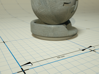

please take a closer look at the LiveDB material editor that you can see in this screenshot:
As you can see it has a scale that says "10cm". The purpose of this scale is to define how the material should look like, how large it is. SketchUp uses units, e.g. meters for its model. So it is clearly defined how a material has to look like when applied to a SketchUp model. It certainly must NOT take any UV-map-scalings into account as in your first two screenshots, because the size of the texture and its scaling is already part of the material description. I certainly know that the scaling can be changed in a material, but it doesn't make sense to change it, because it already defines how it should look like relative to the 10cm scale. So there seems to be a bug in OctaneRender.

sorry, I think you misunderstood me. I don't want the material editor/sphere to be changed, it is fine as it is. But the material editor is used to define a material. You can see in my screenshot of the material editor how the material should look like. And when applied to my model, it doesn't look this way in one of the two cases because it is incorrectly scaled by OctaneRender.

The problem is that the UV scaling is dependent on the mesh, and it is not exported from the application. For instance in your living room example 1 unit spans the entire room when you use the floorplan (it needs to, because you don't want to tile the floorplan), but 1 unit spans some fixed distance when you use the wood texture (assuming it is tiled). That is why the stone texture gets scaled differently for those two cases. Octane has no way of knowing the unit length for the UV coordinates it is getting.
The cm scale is mainly there to scale procedural textures.

Oh, sorry, you are right, I didn't think about that!
To know the size of the UV vectors it would have to take into account the size of the mesh. So you are right, it isn't sufficient to "normalize" the UV vector.
I now first thought that you could just compute the correct factor for scaling the material, but the problem is that it may be different in different areas on the mesh based on the projection of the texture (e.g. on a sphere). It would only work on flat surfaces.
Sorry, so the 10cm scale in the material editor is just to let the materials in the LiveDB have a similar scale. Ok. Sorry for the long posts and the many questions! It is a little bit unintuitive, but you are right, there doesn't seem to be a general solution for this problem
