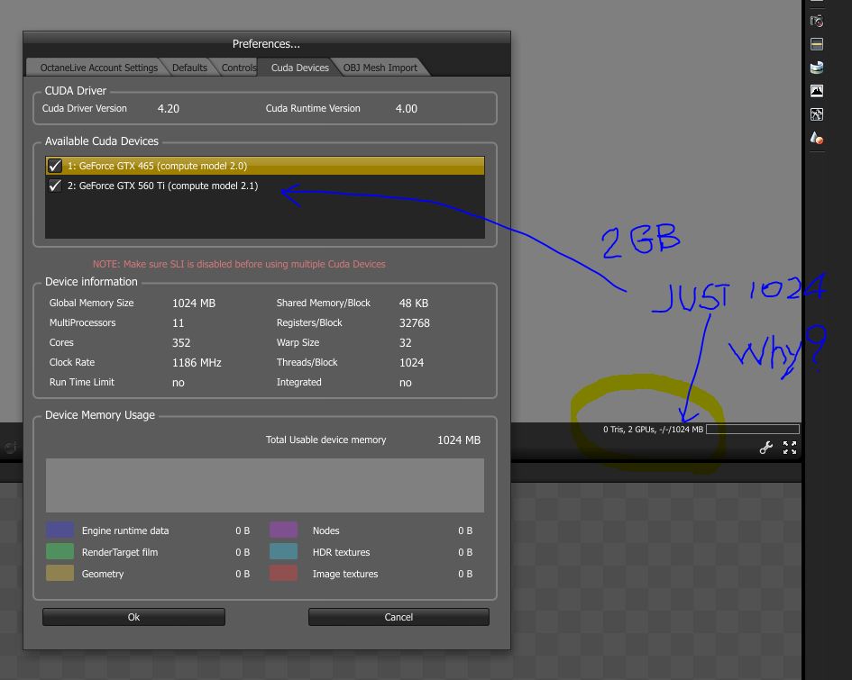

I have 2 graphic card between gtx465 and gtx560ti.
I want to know what the first in pci ex 16. Because on mainboard it have 2 pci express 1&2.
I should be install gtx465 in first pci or in 2pci??
help me please how install graphic card

Presumably your other card only has 1GB of ram? Octane has to have 2 cards with identical memory. So if your other card does only have 1GB then I'm afraid that 1GB is all you will be able to use.
Ah yes, just seen your other screen dump. So yes your other card has 1GB of ram. If you want to use 2GB then you will have to disable the other card from Octane.
