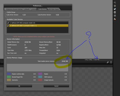

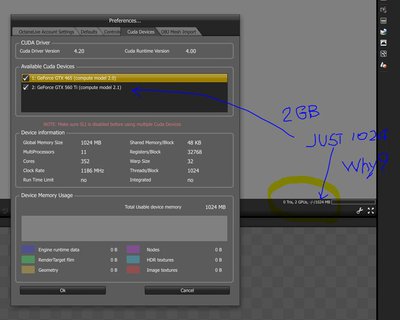

I try to swap 2 gpu between gtx465 and gtx 560 but why mem card use 1024mb? see image
anyone know this please help me.

this image show device.

Presumably your other card only has 1GB of ram? Octane has to have 2 cards with identical memory. So if your other card does only have 1GB then I'm afraid that 1GB is all you will be able to use.
Ah yes, just seen your other screen dump. So yes your other card has 1GB of ram. If you want to use 2GB then you will have to disable the other card from Octane.

How can i use the second card (gtx465). If I want to use for display only. Can you guide me?
pixelrush
Posts: 1618
Joined: Mon Jan 11, 2010 7:11 pm
Location: Nelson, New Zealand
Just uncheck it in the panel you posted a screenie of.
Checked ones are actively used by Octane for rendering.
