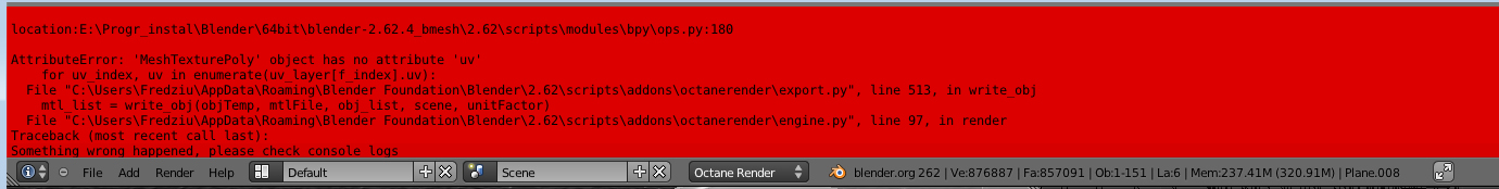

Hi blenders collective!
Did you have the same problem? and what the F@#% is this!
please help me understand this error. :(
Regards.

Don't use a mesh build yet. The code for UV isn't done, among other things.
Go back to the official release Blender 2.62 and use script 1.13 found in the post :arrow: [Unsupported] Plugin camera fix for recent Blender builds

Guys, can you give a try to attached 1.14?
It should fix the uv exports but not the normals, so disable their export please.
octanerender.v1.14.zip
(61.96 KiB) Downloaded 268 times

yoyoz wrote:Guys, can you give a try to attached 1.14?
Hi yoyoz!
"Completed in 0h0m18.71"
Works fine! :)...and the problems with Normals, you mean "Normals: Flip Direction"?
Regards and thank you yoyoz!

Piernik wrote:...and the problems with Normals, you mean "Normals: Flip Direction"?
Nope, it's just that since bmesh, normals are exported in a different order as before. I've opened a ticket for that so I can see how Campbell fixes it in the wavefront exporter.
aLeXXtoR wrote:Thank you for your update! But I got errors — I loaded my complex production scene and got this message
Quite strange error, as none of the parameters are supposed to be of type 'byte'...
You can try the following:
- upgrade to newer build
- disable verbose logging
[EDIT] I'm also at 44639 at the moment

@aLeXXtoR: issue fixed with new version: http://www.refractivesoftware.com/forum ... 32&t=14875
