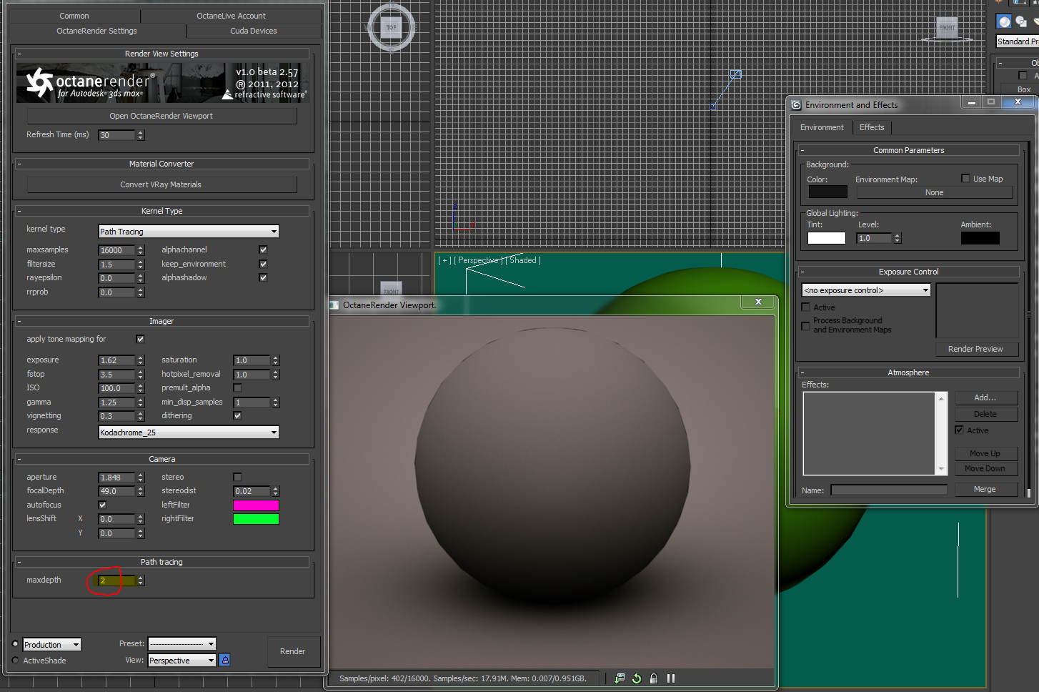

I have a question I would like answered, I think it might be a rather significant bug.
I just downloaded the max plugin for 2012. and I have run into this issue.
For both pathtracing and PMC I'm running into the problem, of serious over lighting when I enter a max depth more than 2.
I would really like to use this plugin for a project I'm about to proceed onto, but as it stands it is seems to be very buggy.
I anyone could help me figure out what this is I would be extremely grateful. I'm under the gun so to say.

check ray epsilon and your scale.Draydin_r wrote:I have a question I would like answered, I think it might be a rather significant bug.

Some times it can happens bacause of plugin licence.Draydin_r wrote:I have a question I would like answered, I think it might be a rather significant bug.
Try to do next
go to
C:\Users\Andrey\AppData\Roaming\Refractive Software (just type
"%appdata%" in command line to get C:\Users\Andrey\AppData\Roaming\)
And remove all folders with name inside {}, like
{d3d9446802a44259755d38e6d163e820}
Sorry for delay.FamilyGuy wrote:Thanks gabrielefxNow it's working perfectly. No I can finish my project.
Edit: It's not perfect because I lost posibility of real time preview. I hope that soon it will improve.
Yes, it was a bug.
I have fixed it. Wait for next release.
