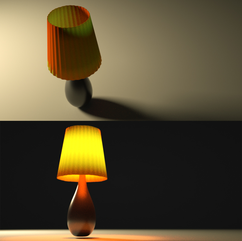

ribra for real SSS to work you need the object to have width, single sided objects won't look good with real SSS, with those you can fake it to a extent mixing difusse + specular.
For the real deal, in this case I think a difuse SSS would work good, I've done a quick model with a lamp shade with some width althou I think it's too much for "paper" more like a plastic one, but you get the idea, I've included the scene so you can play with the setup, basically you create a difusse material, add a medium node and a transmission texture (without it wont work), and you play with those values, the most important one is scale inside the medium node, that'll will control how much scattering you get along with the scatter value.
Hope you don't mind I've added my humble test images to your thread.
It can be improved, so if anyone is interested, you can upload again the scene with your parameters.
In the scene to see the effect better I've used an orange color for the shade and a yellow one for the transmission, so the effect is not subtle at all, but it can be clearly seen.
