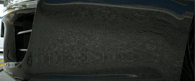

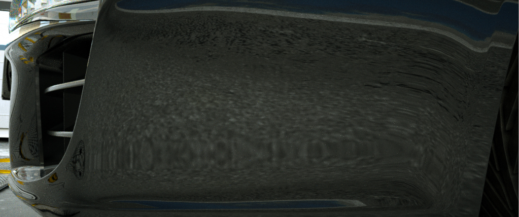

Strange Effect with Reflection
Hello Roeland, I moved the camera closer and farther away but the effect is still here.roeland wrote:niuq.cam wrote: That is a normal reflection on a reflective surface that is curved inwards, if you look for it you may find this effect in real life. It happens if the camera is close to the focal point of the mirror. If you move the camera closer or farther away, or change the curvature of the mesh, it will be gone.
Roeland
However, I understood that it depends on the curvature of the mesh.
Thank you.
