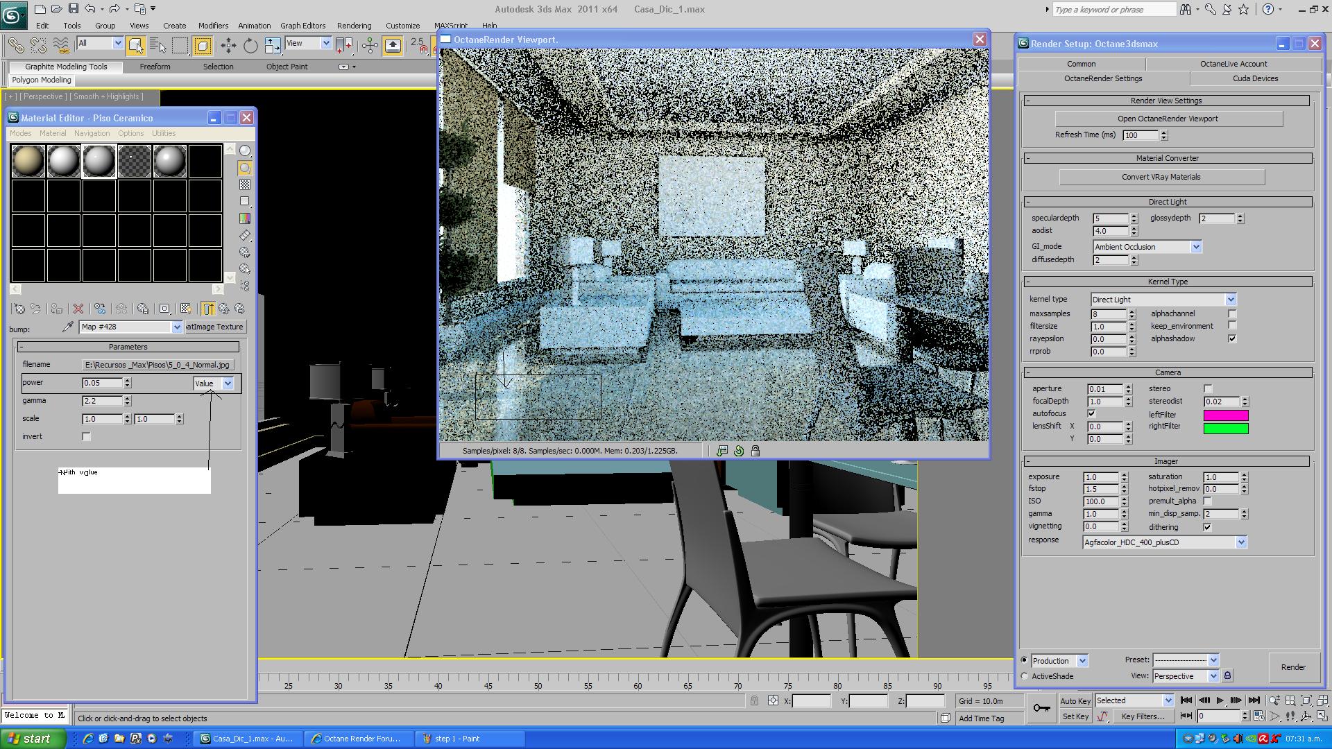

merid888 wrote:hi karba i have few comments to do
first
in the image directligth is so clear into 3ds max
in the image pathtracing have a lot noise with 100 maxsamples into 3ds max
in the standlone image is pathtracing same scene with same values and the image is clear
question: why happen this ?
the other question is, why i can't reflect 100% in the tiles or another materiales ? looks so poor in reflect
i would like to know if you can give me an answer
thank you for read this post
happy new year 2012
That is the bug with pathtracing/pmc.
I will fix it after christmas holidays.
About reflection - May be you use too small index or your reflection color is too dark...
