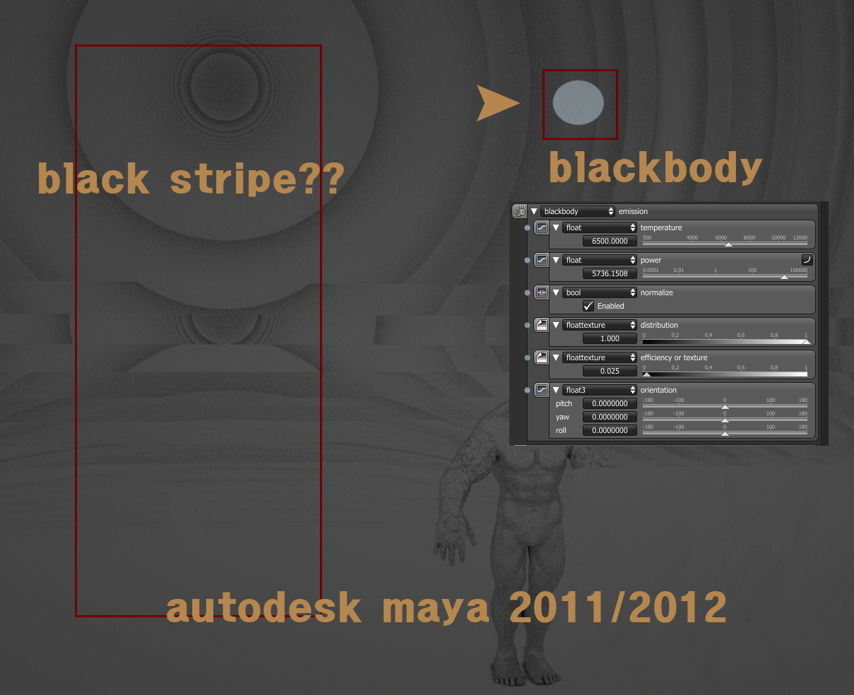

Hi, I'm a user of Octane.
I'm using Octane pug in 3Ds Max and Maya both.
There is no problem about using Octane plug-in on 3Ds MAX 2010. I can export data to Octane well.
But, when I used Octane plug-in of Maya, a problem occur like an image below.
I installed Octane for Maya 2011 on Maya 2011 and 2012, and export data to Octane.
Then background object have black stripe and when I insert blackbody on meshed for lighting, they don't have light effect.
Please answer me. I really curious why this situation is happening.

your scene scale is too big, those circles you see over the model is the result of that. change it from octane to centimeters

lixai wrote:your scene scale is too big, those circles you see over the model is the result of that. change it from octane to centimeters
hi, lixai
Thank you so much for your quick response.
object scale problems been sorted out, but when I switched.
However, taking the view renderer Octane I vary the camera position or model files I've seen in the distance.
Anyway, the problem has been resolved.
Thank you.
