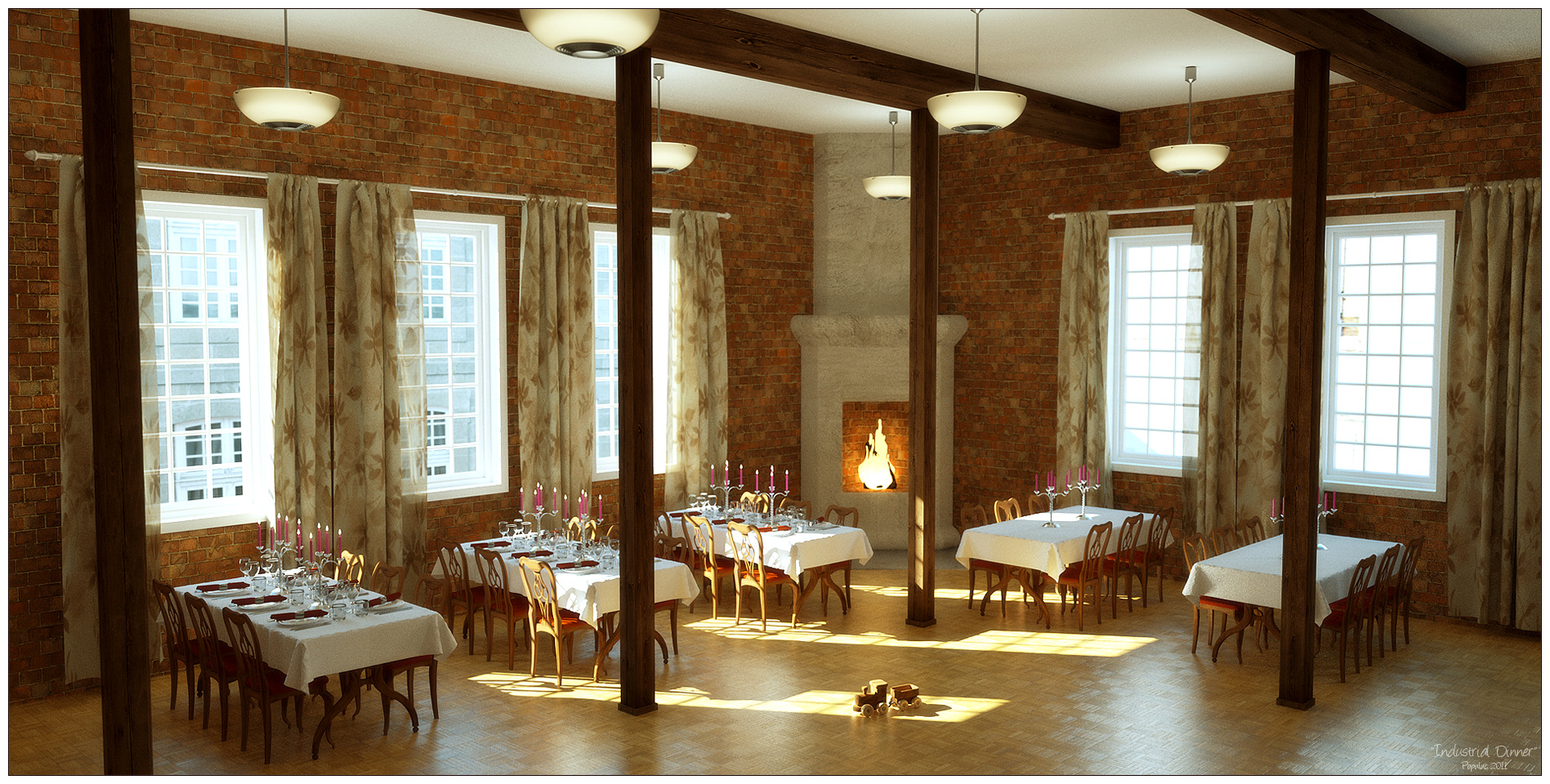

Modeled in Modo 501. Chair design based on a model from 3darchive by Denis Shtein. Rendered in octane beta 2.55b with pt for about 3 hours @ 4096*2048. Color/contrast adjustment in ps. Thanks for stopping by!

Populus wrote:Modeled in Modo 501. Chair design based on a model from 3darchive by Denis Shtein. Rendered in octane beta 2.55b with pt for about 3 hours @ 4096*2048. Color/contrast adjustment in ps. Thanks for stopping by!
wow, fantastic! how much tris, vram use, render time?

Thanks, about 3.6 Mil tris. 644 MB vram for geometry, 144 MB for textures and 950 MB in total. Rendertime ~ 3h on gtx 470 + 480.

nice... the lights look really realistic, it's sss right? .. the fire needs a bit more work, it's too bright.. nice stuff man

Thanks, yes the lampshades has sss shader applied to them (I have not understand the sss in octane completely, but I guess they turned out ok...) The fire was a little bit of experiment; the mesh is made in sculpris and I used a material mix between diffuse with blackbody emission and a specular material for a bit of transparency. I agree it could use a little more work though.

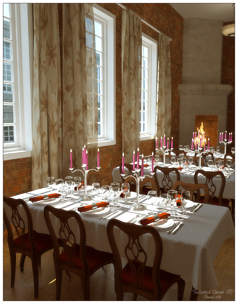

Had to shoot a fast one of the tables as well.... just a little over 1 hour rendertime @ 1800*1400.

hi, fantastic image friend, how do you manage to get the short rendering time? i have a gtx 580, and with a scene the third as complex of yours it takes 8 hours to clean up.
what kernel did you use?
Did you use portals in the windows?
thx
nice work

@ jp_vas: Glad you like the image! The scene is rendered on a gtx 470 + gtx 480 (I´ll go update my profile right now... :oops: ) and use pt render kernel, no portals.

very realistic renders..great work mate !!
