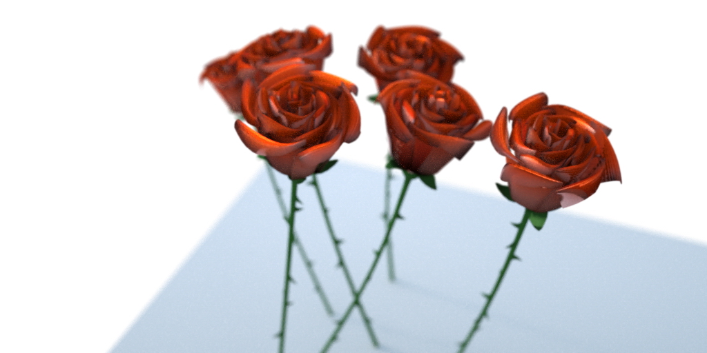

Since I've done myself some roses for a new entry for the apocalypse contest (they are low poly medium, long distance, so the geometry is not great) this is the texture I've made, hope it helps you I can add the macro if you want, I hadn't texture it yet or test it, I'm in the modeling stage of the whole scene, but I wanted to do a quick test for you or anyone else that might find it useful. The material needs some tweaking and the texture I used to control the mix is just a simple gradient 300x300 so won't be too regular, in the wip you can see the specular setup. Althou this is just a "workaround" for now, with the new build we'll have SSS which is what I'm planning to use as texture, hehehe
Also they are too glossy yet, I've got to level the "control" texture.
For light I've used an HDRI and the tests are rendered in PT in a few minutes (1-2)

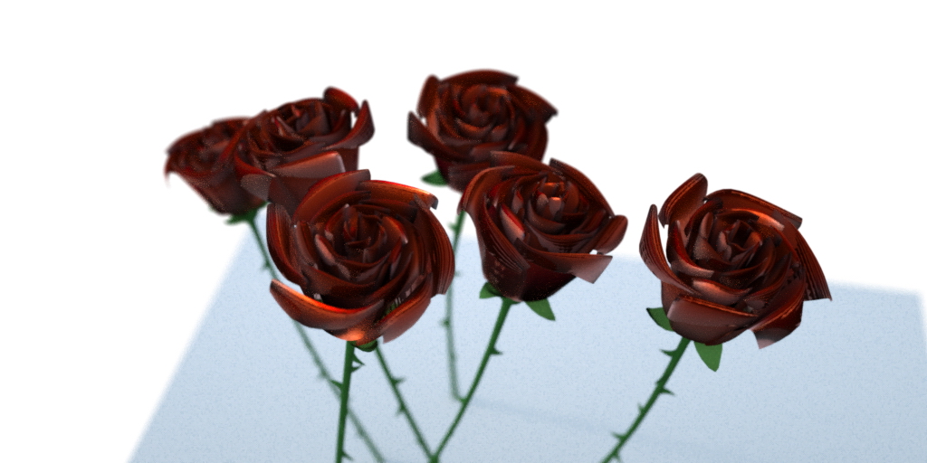

hahahahha, well you can forget about what I said yesterday, here is a quick update on SSS and the rose petal material. Same setup but without roughness for the specular material and add a scattering medium to it and play with its values. (and of course don't forget to get the new 2.55 beta
