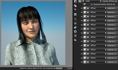

Thanks for pointing that out to me, I remember those being posted somewhere but hadn't found it again. Will have to do some more tests, but I'm still re-exporting more often than I would like trying to get things to work. While my limited ram and the 40 texture limit in Cuda don't help me much, my biggest frustration is still the Daz OBJ exporter because it includes materials of hidden geometry in the list when I bring it into Octane. Whether or not this trips the 40 limit, I'm not sure, but not that many unique textures are being used, though many material zones refer to them.
*Edit*
I've been experimenting with processing the OBJs from Daz through MeshLab before bringing them into Octane. While it does eliminate most unused material zones (due to hidden geometry not exported), it has the unfortunate side effect of renaming all of them. Also, the transparency settings got lost during the conversion.
The OBJ exports from Daz Studio appear to include all material zones, regardless of whether or not they apply to hidden geometry. The original export of the OBJ in the picture had 43 material zones, which Octane choked on. After Meshlab cleaned up the MTL to just 14 material zones, however, Octane handled it just fine. This would seem to indicate that if the MTL asks for a texture, Octane will load it whether or not there is any geometry for it? At any rate, I've started a thread over at Daz's Forums to figure out whats up with their OBJ exporter and how it handles MTL creation.

- Status Text: "87568 Tris, GeForce 8800 GTS 512, 181.4/328/464 MB"
- Daz 2 MeshLab 2 Octane Sm.png (113.26 KiB) Viewed 5128 times
