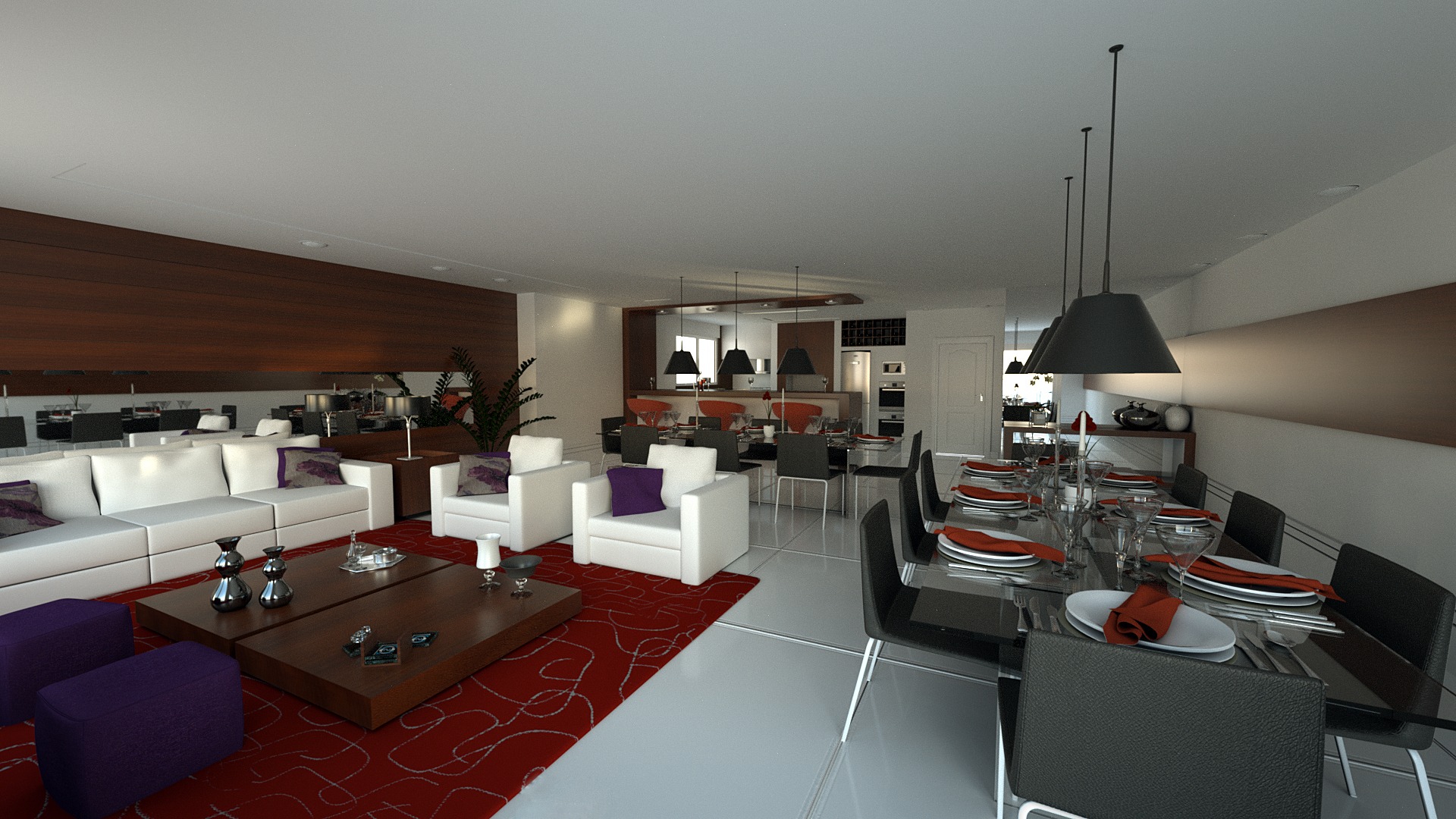

Thank you Vagos!
I tried your tips and i get much less noise, this render below was made with 35.000 samples instead 64000.
About Portal, I don´t get results, Portal for me doesn´t works and I follow exactly what radiance posted in his topic telling about portals...
I will create a topic about this later to see if someone of octane team can explain me why portals doesn´t work with me.

I use to render a bit higher resolution and then resize the image becuase small noise will be reduced then.
Portals are still in development so it wont work on each situation. You cant have glass windows if using a portal as written in the portal tutorial thread.
