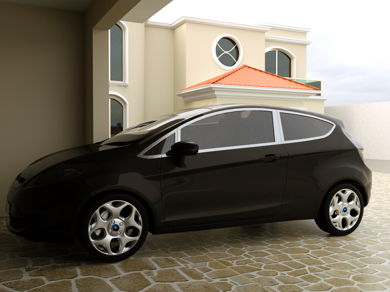

esta es una prueba de render exterior para saber que tan rapido es el octane 2.52, espero criticas y comentarios, modelo hecho en 3ds max 2009 x64, exportado y renderizado en octanerender 2.52, imagen de 1600 x 1200 pixeles, maxdepth en 6 y maxsamples en 1600, tiempo de render 12 minutos 35 sgundos
this image it's done into 3ds max 2009 x64 and exported and rendered by octanerender 2.52, size 1600 x 1200, maxdepth 6, maxsamples 1600, time rendering 12 minutes 35 seconds

In addition to the floor bump, I think you need to close the scene with some trees/plants to make it more interesting. Also if you brighten the car color a bit, it will show more details.

the brigthen
about the bump i been put the value less maybe 0.003 i think so i need put more value 0.003 to 0.1 or 0.07
i will test and i will upload the imagen again
thank you for comments

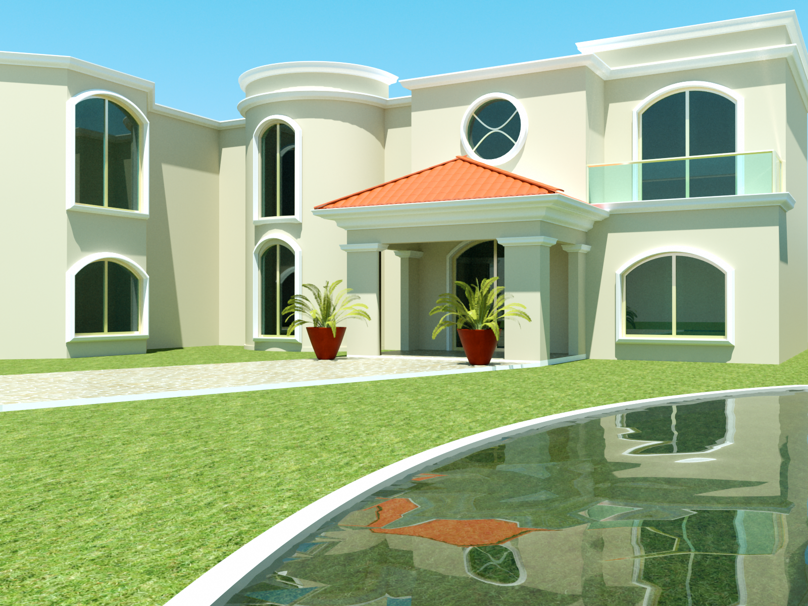

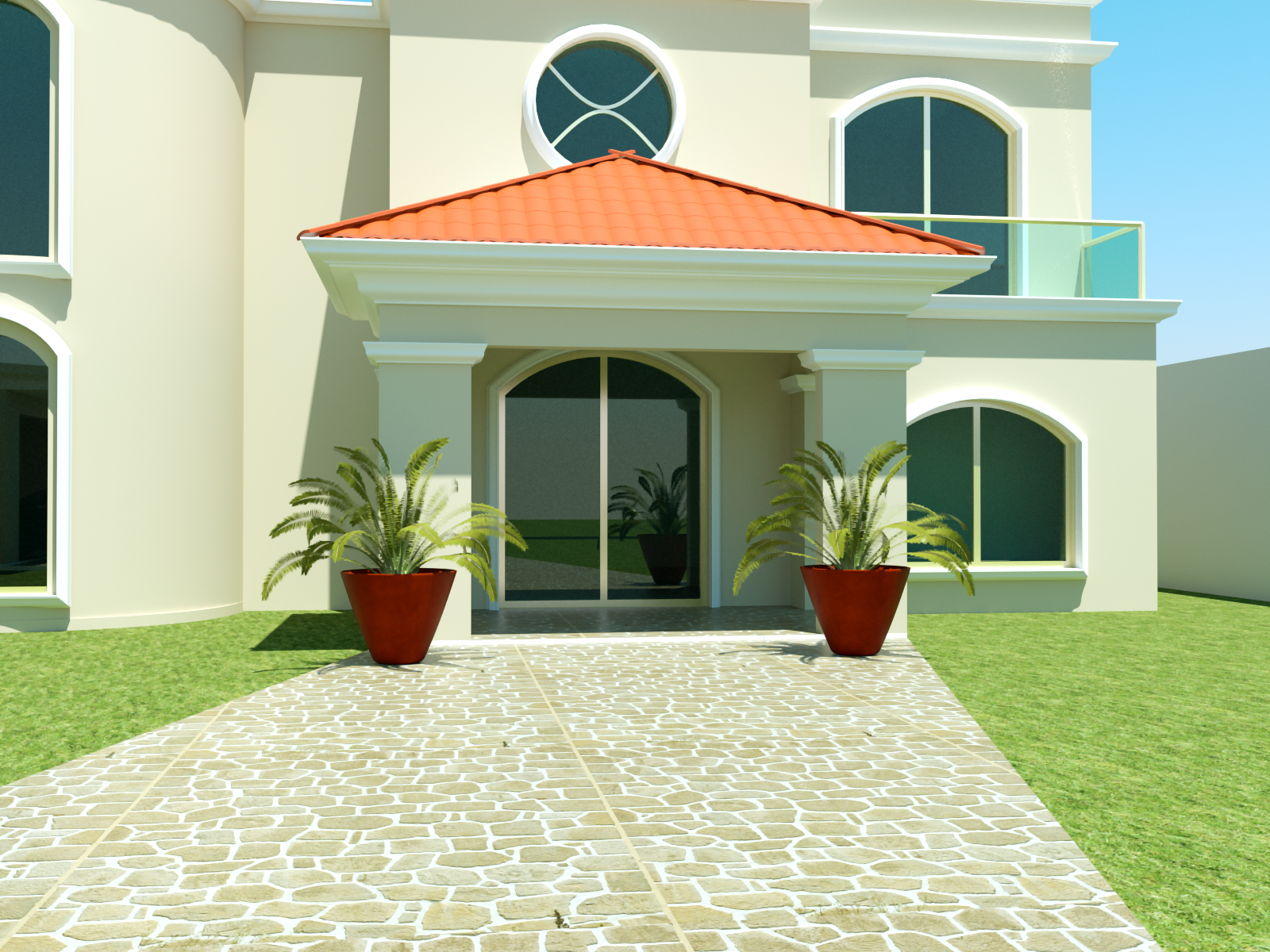

hi hmk, i can put the 3d trees marlin into my scene, and the result is genial, palms and trees, but i saw in your profile something about the octanepowertools, i been seen the site and it's fantastic, i have a question, how in the video of house optimize this scene ? becouse my scene have 1 111 285 polygons and it's just a house and 6 palms and 4 trees, and one car, when i saw the tutorial they have only 1 million and have a lot of houses and trees and palms, do you know how i can optimize this process into 3ds max ?

i will up the image today with trees and palms

Hey merid888,
My advice is to manually optomise your models, you need to remove all unneeded polygons by hand, and all hidden polygons as well. This is how we do our models and prepare them for interactive applications and renders. For example the scene you are referring to, was originally part of a big 3d interactive compound that has around 600 villas, all needs to be rendered in realtime. So it is all about polygon optimization in 3dmax, do this right and you will be using your ram and gpu to their maximum. Also we use textures wherever possible instead of polygons, however this might not be a good choice if you will have closeups, but it'll will serve you well on med/long shots e.g. The roofs of the houses are textures on a flat plane.
