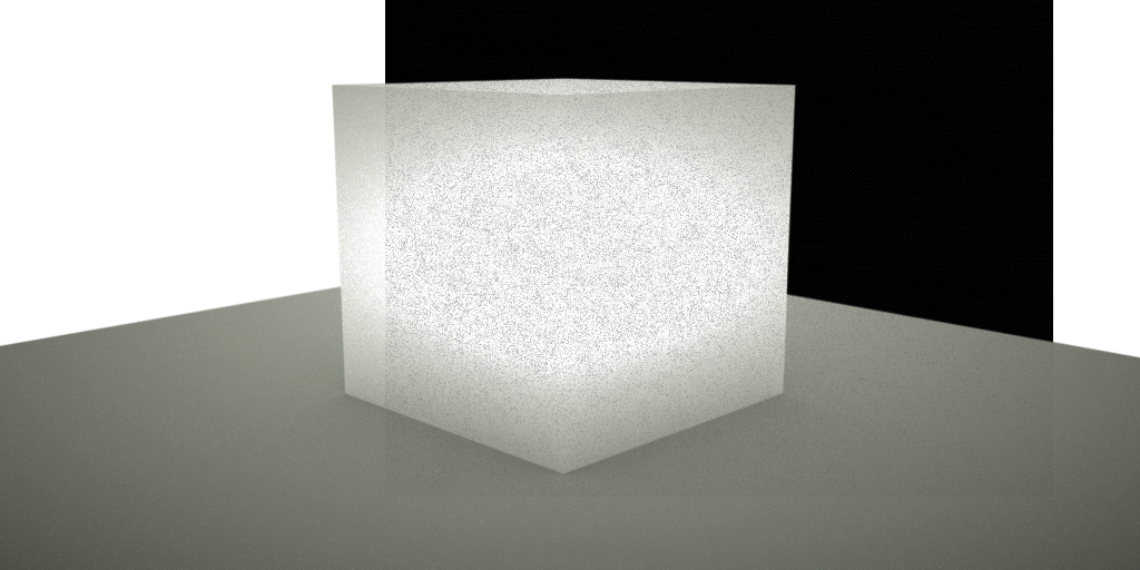

Hi Marcus .
about alpha channel , i was wrong in one think . it works in pathtracing , but in pmc its there and it goes not away
i tested a scene with a white cube and alpha channel .in photoshop i put a black plane in the backround .
when i move the black plane from left to right i can see the slight transparency in the white cube
rendered with pmc 4000 samples
cheers
Rico
Windows 7 , 64 b / GTX 590 / Archicad 15 , 64 b / Cinema 4D R 13 studio , 64b /Intel(R)Core(TM)Extreme3,20Ghz /always latest Octane.

andrear wrote:alpha channel leave a trace of transparency under all the image so when you add an image in post prod. it become visible (barely but visible) under the render image.
example rendered with 248c, PMC kernel.

Hi Andrea,
Regarding the alpha issues: We are working on a solution to make the alpha channel more robust for the PMC kernel. The transparency should vanish over time, but it seems that it doesn't for some reason we have to investigate a bit more.

ribrahomedesign wrote:Hi Marcus .
cheers
Rico
Ok, thanks for the feedback. We will look into this.
Cheers,
Marcus
