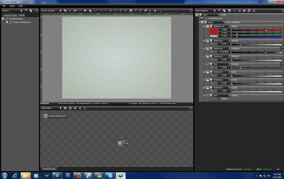

Hi Im not sure if Im doing anythng wrong here but Im just testing exporting a simple cube from max to Octane and all I see is a clear window with nothing in it when octane starts.
Please help not sure what Im doing wrong.

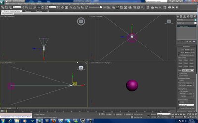

It looks to me that the camera is completely misplaced or. What are the camera node settings (position/target/up vector? Could you post a screen shot of the camera node?

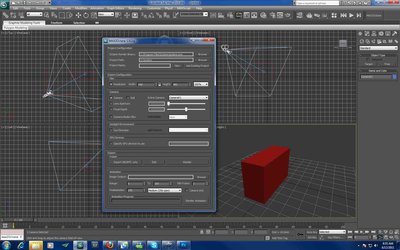

check the units, (in max there is 2 settings for that global and local or something the like) and check the obj export default values <none> against this http://www.refractivesoftware.com/forum ... f=21&t=362 doing a manual export, the script uses the default values stored in the internal max exporter stored under <none> so if by chance you've modified those it could be messing (like having a diferent scale value from 1.0)
